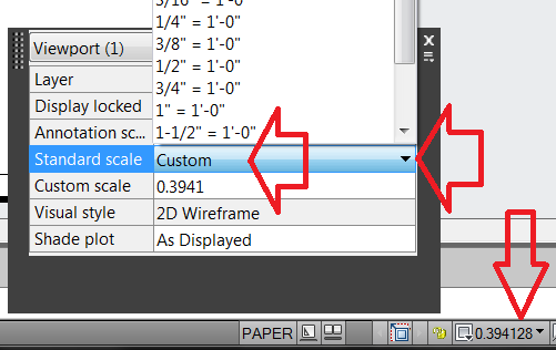

abraCADabra Posted July 25, 2013 Posted July 25, 2013 Check in the lower right hand of the screen. You should see a vp scale box there with a an arrow to scroll through scale sizes. Just remember, if you try to select it while your VP is locked, it wont work. You must unlock your VP in order to use the one in the lower right of the screen. Hope that helps Quote

JD Mather Posted July 25, 2013 Posted July 25, 2013 Attach the file here and end all doubt (you can delete everything from model space). Does it say "Custom"? Did you click on the word Custom and no list arrow appear? Quote

steven-g Posted July 26, 2013 Posted July 26, 2013 The standard and custom scale headings in properties are only available when you highlight paperspace viewports, they won't show in model space viewports, or when a paperspace viewport is activated. Quote

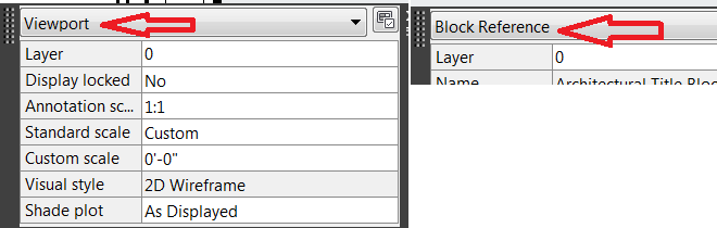

WalterCarlson Posted July 26, 2013 Author Posted July 26, 2013 JD Mather, This is exactly what I am searching for. I opened my paperspace through 'Create Layout Wizard,' clicked on the viewport border expecting what you have attached but instead have 'blue grips' at each viewport border corner. Quote
