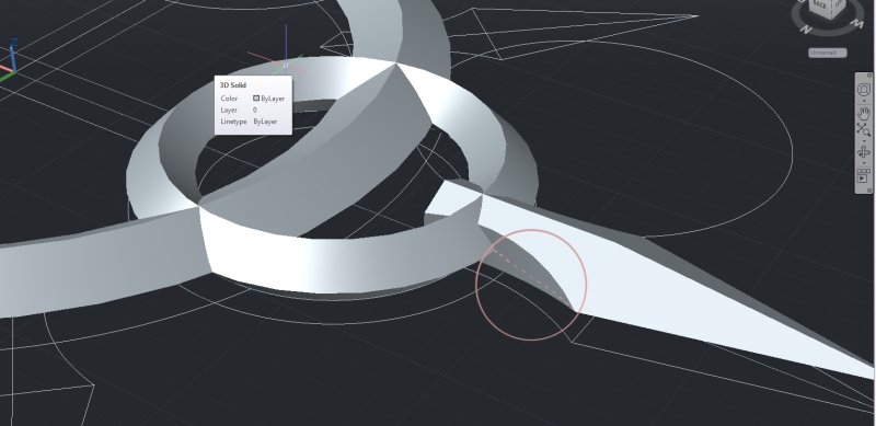

For a while now I have been attempting to resolve a a part of my CAD drawing. As seen below I have a 3D Solid. The part circled is result of subtracting a cylinder from the shape. I am now trying to find a solution to make both the above and below edges of the dotted line meet as one while maintaining the curve I have subtracted. Unfortunately, I cannot come up with an answer. I attempted to chamfer the edge but found this at difficulty. Am I going about this wrong? Any help would be appreciated.

Hard to tell what you have in an image, would be better to post the model.

Sweep two lines as surfaces and the slice.

You will need to Loft rather then Sweep.
I would do 1/4 and then mirror twice (you have already done way too much work - use mirrors and arrays for symmetrical geometry).

Thank you! I will try this tonight. I hope I didn't create too much unnecessary work. I only created the largest piece. Everything else was copied or scaled.
