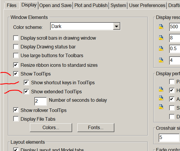

rkent
AC 2014 - On the Home toolbar, Layers, top row of buttons, fifth from left.
What is this supposed to do?
I was expecting it to be the way in which I would access a particular layer exclusively, and be able to work on it without seeing the other layers. That's what I want to do, anyway, if it is possible. How can I do that?
First go to options and make sure you have the boxes checked as shown in the attachment. Then go back to that ribbon icon and just keep your mouse cursor hovering over it, an explanation will appear explaining what it is for. Same with any of the buttons on the ribbon.
Share this post
Link to post

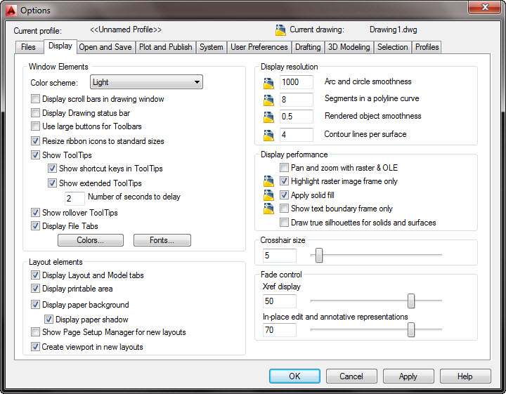

nestly
You are using the Ribbon interface, so I wouldn't worry about the LAYERS toolbars.
The Isolate Layers button (whether Ribbon or Toolbar) locks or hide all layers except the one you pick after selecting the tool. By default, after you Isolate a layer, the layers will become locked, and all the objects on those locked layers will be faded 50% of their original brightness. If you open the Layer Manager, you will see all but one have a lock icon. Optionally, you can turn the layers OFF, or FREEZE them so only objects on the "Isolated" layer will be displayed.
