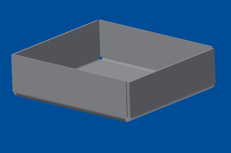

I have a box with an angled flange. Two of the edges are simple to create using the angle option, however making the side flanges results in a 90 degree flange that will not miter with the angled corners... (see pic)
Maybe I am missing something but there must be and easy wan to get the flange to miter to the opposite angles.

When creating the 3rd Flange expand the dialog box to enter an Offset so that the flanges do not intersect (on the one end especially).
Then add Corner Seams between the ends. Adjust solution, Gap and Corner as needed.
Post back with your attempt if you can't figure it out (you left out the 3rd flange in your first attachment).
Worked great JD thanks a bunch... One of those little tricks you would never know...

You might want to reduce the gap and set the overlap and corner differently (or then again, maybe you have what you want).
