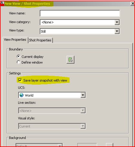

When creating a view, save a layer snapshot, as shown in the image. :)
If you are editing an existing view, choose update layers.
