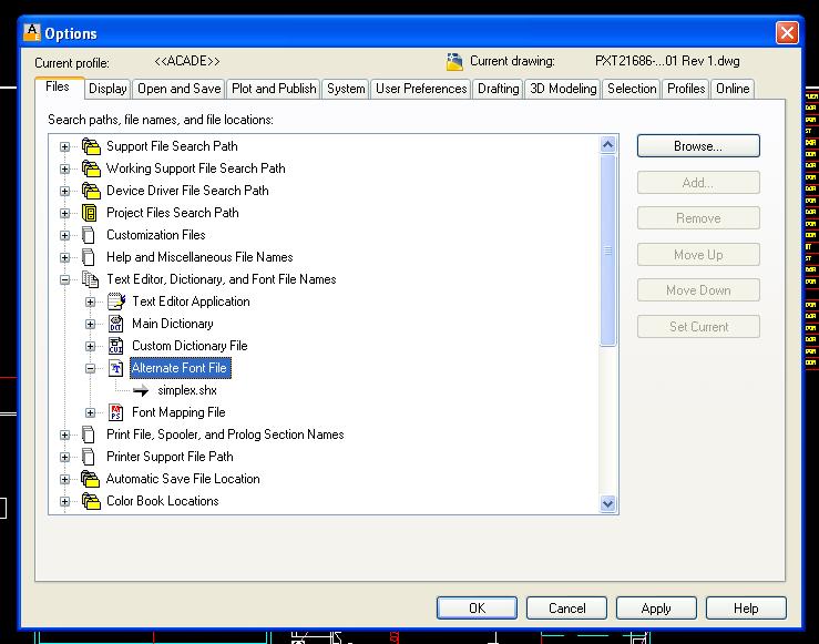

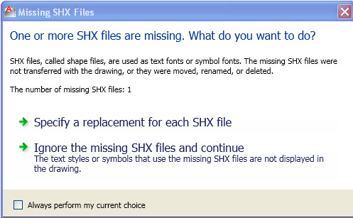

princessmonsta Posted August 2, 2013 Posted August 2, 2013 (edited) My bosses pc's shows up the attached missing SHX files error message when he opens a drawing with missing font files. I have a new install of Autocad and I've never ticked the box 'Always perform my current choice' and I don't get that error message. See attached screen dump. Why does he get that message and I don't? How do I make my Autocad have that error message? Regards, Princess Monsta Edited August 5, 2013 by princessmonsta Quote
dbroada Posted August 2, 2013 Posted August 2, 2013 (edited) One possibility is that you have an alternate font specified and your boss doesn't Edited August 2, 2013 by dbroada Quote
ReMark Posted August 2, 2013 Posted August 2, 2013 Another possibility is you have a custom linetype that utilizes a shape file which your boss does not have access to. Quote

neophoible Posted August 5, 2013 Posted August 5, 2013 My bosses pc's shows up the attached missing SHX files error message when he opens a drawing with missing font files. I have a new install of Autocad and I've never ticked the box 'Always perform my current choice' and I don't get that error message. See attached screen dump. Why does he get that message and I don't? How do I make my Autocad have that error message?If you are using .SHX files, e.g., certain text fonts, that your boss's computer doesn't have, then you would not see the error message, because your computer has them. Have you verified what the situation actually is, yet? Quote
eldon Posted August 5, 2013 Posted August 5, 2013 If you are using .SHX files, e.g., certain text fonts, .SHX shape files need not be uniquely text fonts. I have seen surveys where a common shaped detail has been a shape instead of a block. But the message does not differentiate between font, linetype or symbol shape files. Quote
neophoible Posted August 5, 2013 Posted August 5, 2013 .SHX shape files need not be uniquely text fonts. I have seen surveys where a common shaped detail has been a shape instead of a block. But the message does not differentiate between font, linetype or symbol shape files.This is correct, thus the "e.g." The error message mentions symbol fonts and ReMark noted that it could even be used in a Linetype, thus some searching could be in order. Quote

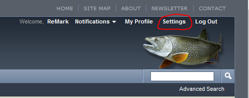

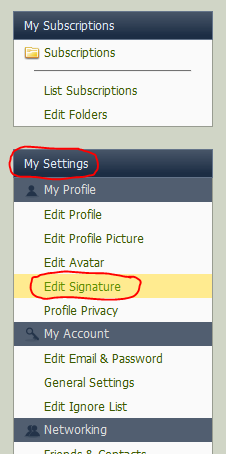

ReMark Posted August 6, 2013 Posted August 6, 2013 Maybe it has something to do with being a newbie to CADTutor and not having a minimum of 10 posts. Otherwise you click on the Settings option in the upper right hand corner of the web page then look under My Settings > Edit Signature (that's what those quotes are called) which should be on the left hand side of your screen. Quote
ReMark Posted August 6, 2013 Posted August 6, 2013 Settings. Then.... My Settings > Edit Signature. Quote
rkmcswain Posted August 6, 2013 Posted August 6, 2013 One possibility is that you have an alternate font specified and your boss doesn't IF it is a missing FONT, then the OP will be prompted for a FONT with this dialog: Otherwise, it's a missing SHAPE file, in which case the OP will get a regular file selection dialog. Quote

Polias Posted August 9, 2013 Posted August 9, 2013 (edited) I would suggest, after you click "ignore missing .shx files" you open up the text-window (F2) and look at what .shx files are missing. ie Star.shx then check your bosses shape file pathing in 'AutoCAD -> Options -> Files'. All of my .shx files are located under "Support File Search Path" ie. "C:\Program Files\Autodesk\AutoCAD Version\fonts" it should be identical to yours (because when you open the drawing you can see the.shx files) Oh, and if you dont know where the missing shape file is (star.shx) do a 'find' in the directory for it. I usually just do a *.shx search and put whatever shape files I can into my own private reserve so im never caught unawares Hope that helped. Ian Edited August 9, 2013 by Polias extra info Quote
