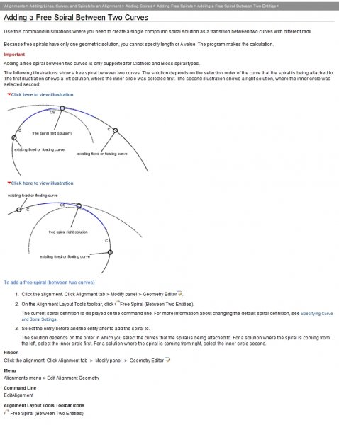

I am using Autocad Civils 3d and for the last 3 days I have been struggling to create a transition between 2 arcs.
Arc 1 has a radius of 1260387.4276 & Arc 2 has a radius of 1004689.5343.
What I need to do is create a transition (any type of transition, clothoid, cubic parabola etc) between arc 1 and arc 2 such that the transition is connected between both arcs tangentially.
I have attached the AutoCAD file that contains the 2 arcs, can anyone have a crack at it and explain how you did it.
Thank you.
Help With Transition.dwg
You can simply draw a connecting arc between your other two arcs.
Select the arc command with start point, end point and radius. Set your object snap to tangential and pick the two arcs. When prompted for the radius enter a value bigger than both of the radii of your existing arcs.
Because your arcs are so close together and their radii so large you could also connect your two arcs with a straight line. Why does it have to be an arc?
Would drawing a circle between the two arcs using the TTR option then trimming away what isn't needed work? Unfortunately I am not on my CAD computer so I can't open and look at your drawing.
That would work too ReMark.
If a straight forward arc or line will not do then check your Civil 3D Help searching for "Adding a Free Spiral Between Two Curves". It explains how to create a clothoid between two arcs,
Perhaps draw a spline between the ends of the arcs. As they are arcs, you know the tangent direction of each of the ends, so you can align the ends of the spline curve.
This is of course only using vanilla AutoCAD.
If it is to be a proper transition curve, you would need all sorts of other information, like the length, so that the proper lateral acceleration is applied.

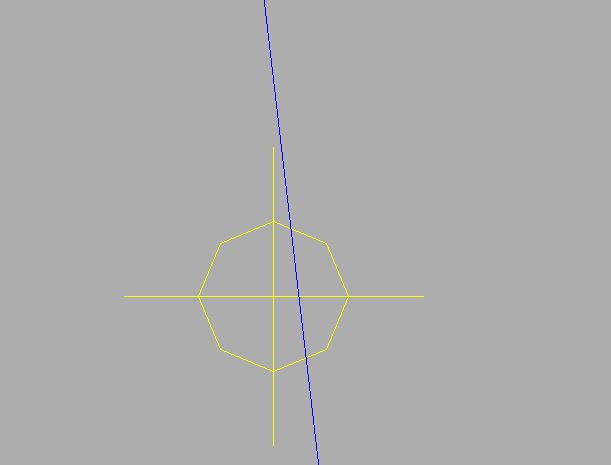

I have a series of points that represents an existing alignment.
I have created (via arc of best fit) two arcs (shown in pink & green) that go through some of my points (see attached autocad file).
I need to create another arc that connects the two existing arcs tangentially; also the new arc should be as close to the points as possible ideally
More than 1 arc can be used to connect the existing arcs and the existing arcs can be trimmed but the above restriction still applies, needs to join to the other arcs tangentially and the distance between the points and the new arcs ideally be
Can anyone help; I have been trying for over a week with little success. Please can you be detailed in your response and if possible can someone have an attempt.

Parametric software reveals that there is no solution with an arc - a spline will be needed to connect the existing arcs with a tangent curve.
Oh wait a minute - looking at your new information in the pdf you changed the problem.
Let me check for a solution with the new information.
In your original problem it I thought you were stating the ends of the magenta and green arcs were known and you were trying to connect these endpoints with a tangent arc - there is no solution.
In your pdf you show a red convex arc tangent to the magenta and green wherever it is tangent.
There is a solution for this, but the solution radius puts it significantly larger than your plotted points.
There is another solution with a concave arc that is much closer to your plotted points.
The solution can be found by using Parameters in later versions of AutoCAD (not sure if r2011 had Parameters).
I will let others try and then post my solution tomorrow.

I have a solution, but it is not an arc. It is the tangent between the two arcs.
If the magenta arc is extended some 7000 units, then it is possible to draw a line with the Tangent Osnap between the two arcs. Then the arcs can be trimmed and the green arc is shortened some 5000 units.
To help me to arrive at this solution, I changed the Point to be a cross with a circle, and setting the point size as 80 absolute units, you can see visually whether the line passes within 40 units of the point. I think they all do.
Edited by eldon
picture added
Draw a short line section at the position you need the arc to pass through the points. using draw circle tan, tan, tan, pick appropriate poits on the existing arcs and the line, then trim back the resultant circle. Does that do what you need?
