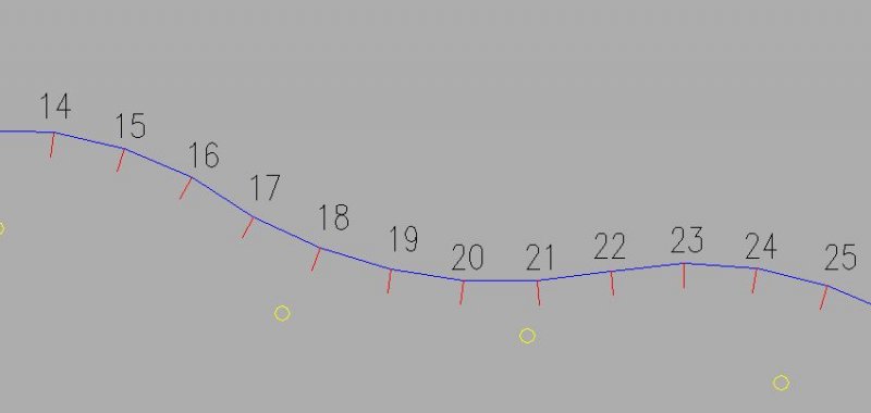

The building I am working on is the shape of a jelly bean. The exterior glazing will be segmented and we are trying to make the building as dimensionally uniform as possible. IE 5'-0" Curtain Wall units. So each arc length needs to be perfectly divisible by 5'-0" and the transitions from one arc to the next must occur at a tangent point.
Any ideas on how best to draft this out. Eventually we will be developing the building in Revit 2013 but for now we are in ACAD 2013.

Investigate the Parameters tab.
You might also look into Measure and Divide commands.
Thanks I was able to constrain the arcs to be tangent to one another. Now just need help on the arc length uniformity of 5'-0". is there a different CAD software out there that this type of drafting might be better suited for?
So you want to draw any arc with any radius possible but the arc length has to be divisible by 5'-0"?
We have the building drawn, but now are being tasked with making it dimensionally efficient, cost effective, and constructable. If all the curtain wall units are 5'-0" wide then it will be easier for the contractor to build. Some of our arc lengths of the jelly bean are close to being divisible by 5(off by a 1'-0") but others are right in the middle. IE a arc length of 77'-6" or so. We can flex the shape of the building to make the shape constrained by the tangents to the arcs and each arc to be divisible by 5. I am quite skilled in CAD but I do not know the best way to modify the line work we already have other than trial and error.

It is unclear to me whether your constraint is Chord length or Arc length?
When I did a bit of setting out for a curtain walling firm, the glazed units were straight.
So perhaps the chord length is what you should be watching, not the arc length. :unsure:
Once you have the shape drawn with arcs use bpoly to make a continuous pline. Then break that at a logical location to control where the first curtail wall panel would start, set pdmode to 3, then use measure and 5' as the distance. You will have nodes every 5' along the curve. Continue from there.
Another point to consider is that if the exterior face does go in a series of straights, the position of the tangent points is not an over-riding consideration.
Thus a unit spanning from one radius to another would not detract from the appearance, and you would not have to worry about arcs being so exact.
Rather than worry about the length of an arc I would make a block of the panel 5' long, then using measure on the continuous pline or spline, specify that block, and a length of 5'-1" for the spacing in the measure command, or what ever works depending on the overall size of the building.
Thanks all. I have made the overall length of the jelly bean the required length so that when I divide the length of the polyline by the amount of glazing units, the CHORD length is exactly 5'-0".
