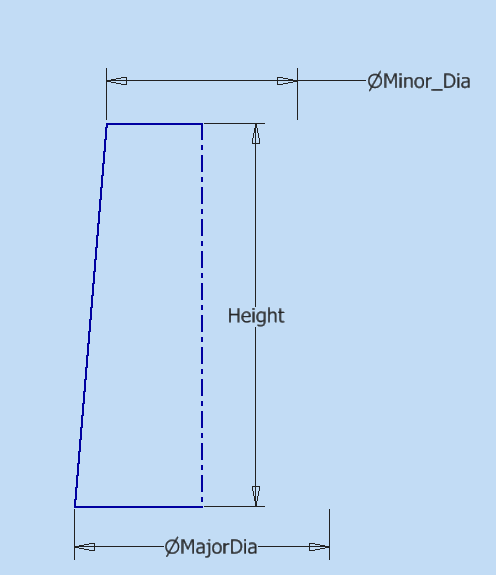

JD Mather Posted August 8, 2013 Posted August 8, 2013 Revolve is far easier than Loft. With loft you need to move (or create) circle to elevation. With revolve you simply create 4 lines, dimensioned to your major diameter (or radius), minor diameter and height. If you use Parametric dimensions - you can easily change. Quote

rkent Posted August 8, 2013 Posted August 8, 2013 Revolve is far easier than Loft. If you use Parametric dimensions - you can easily change. [ATTACH=CONFIG]43371[/ATTACH] Are you saying the parametric dimensions will change a 3D object? Can you walk me through that? Quote

JD Mather Posted August 8, 2013 Posted August 8, 2013 Are you saying the parametric dimensions will change a 3D object? Can you walk me through that? Not in AutoCAD. Set DELOBJ=0 and if you decide to change double click on the dimension to change and then Revolve again after change (delete the original solid). I have no clue how you would do that with two circles (in AutoCAD). Quote
rkent Posted August 8, 2013 Posted August 8, 2013 With either revolve or loft you just grab the grips and adjust the size by typing in a value to increase the circle by. I misunderstood you concerning the parametric dims. Quote
