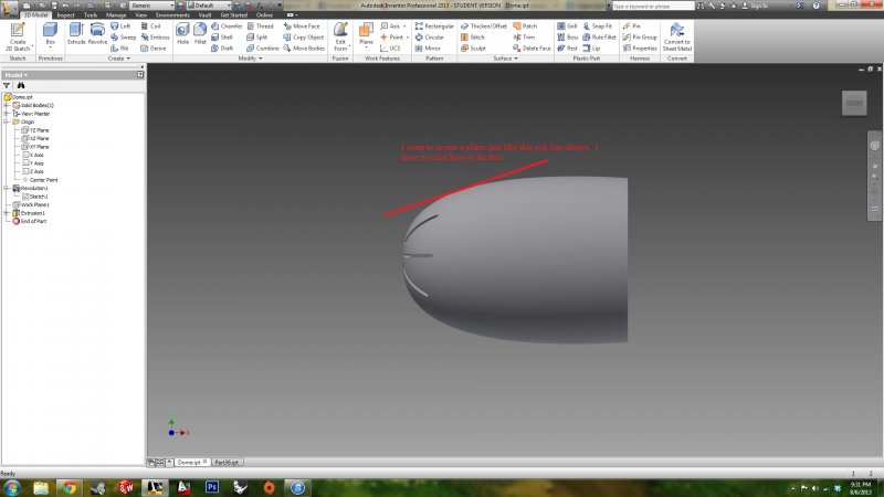

I'm a bit of a noobie here. I have been using inventor for a while on and off as a student, and I finally got a job where I need to use it for some things. For practice I decided to draw up the desk lamp that is next to me. Anyways, I need to create a work plane at the place that I've shown in the attached image. This is so I can place a hole where the cables and what not go into.
I have no idea how to create a plane that is tangent to the point on the curve that I want. It's really bothering me :unsure:

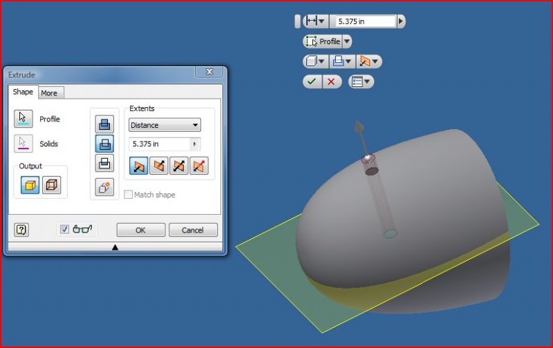

Easier way may be just create an angled work plane off your original plane and extrude cut...

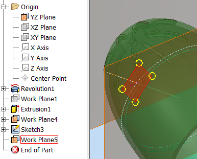

Create sketch line to define pierce point on face.
Start the Workplane command, but - (this is the trick)
Right click and select Create Point and then select the line and the face - Inventor will find the pierce point intersection and create a workpoint.
Now select the workpoint. (this could also be done in two steps rather than using the right click trick)

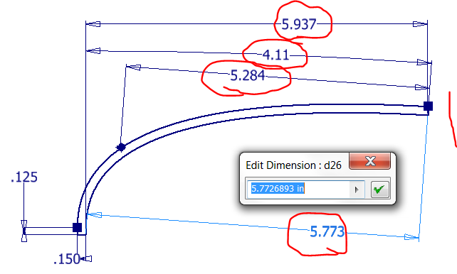

Sketch1 looks like you used the Autodimension tool rather than do YOUR work.
The result is dimensions that cannot be inspected and therefore a part that cannot be manufactured to specifications.
Also the right side line (in image attached) is not vertical. Is this really really really what you want? Tell me the angle of that line?

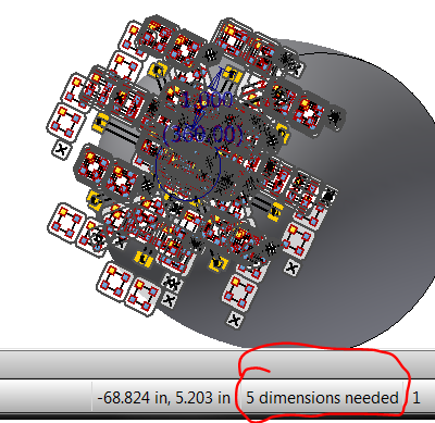

right click and select Show All Constraints.
Is this what you really really really want? All of these constraints are going to make your file size larger than needed and start to bog down your assembly.
Pattern Features rather than Sketches whenever possible.
... and your sketch wasn't fully constrained.

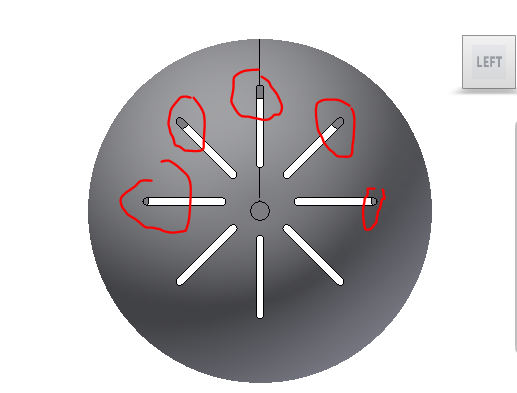

Now go to the Left side view on the View Cube and examine the slots.

[ATTACH=CONFIG]43328[/ATTACH]

Ok, I finally got it. I'm not sure if I did it the exact same way you are referencing. I opened up sketch one, placed a point where I wanted my plane, finished sketch, the in the 3D model I turned on the sketch visiblity and used the "Plane tangent to surface through point" command to make my plane where I wanted it.

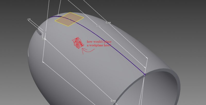

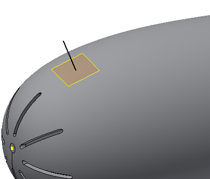

However, the only problem I have with this is that I can only make my plane where the original 2D sketch lines are on my 3D model. I tried dragging the point somewhere else on the 3D model, but it only drags along the line (obviously). What if I wanted to place my plane, say, here (shown in the image)?
Same way you created the other workplane.
