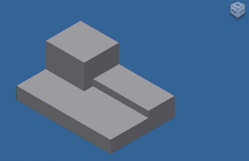

Views orientation are not correct in Inventor!
I have this problem for a while but I had enough.

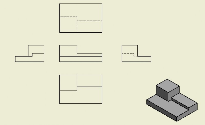

Basically, according to what I learned at Uni we define views like this:
http://rutherfordschools.org/rhs/TM/Year_03/Park/pg1.html
but in Inventor it is the other way around! like the "Left" is for the "right" and the "Top" is for the "Bottom" and visa versa!!! (Please see attached)
Also the XYZ must be the other way around pointing Z up and X & Y on Right and Left.
Can anybody help with this

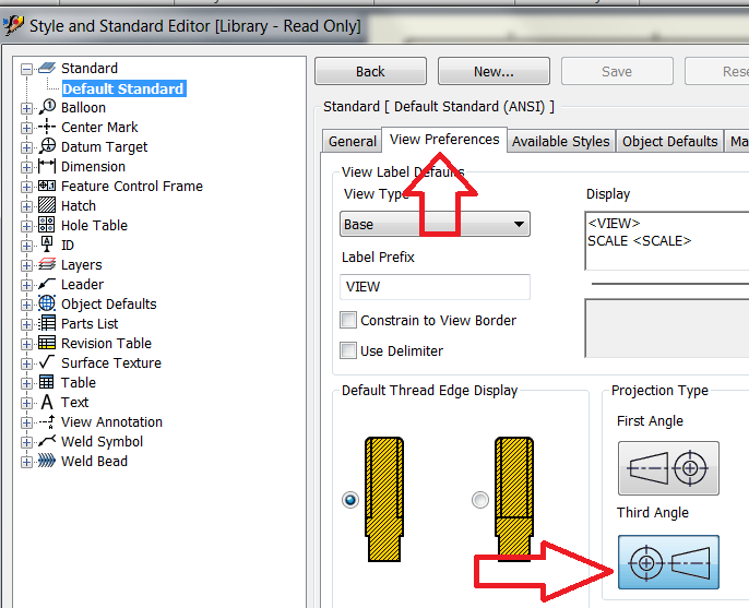

What template are you using?
What Style?
There are two types of orthographic projection use around the world.
Your Style is currently set on what is referred to as 1st Angle Projection.
You want to change it to 3rd Angle Projection.
Many Thanks!
What about XYZ thing?
