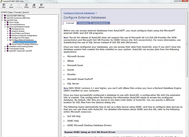

DanielD Posted November 21, 2008 Posted November 21, 2008 I downloaded an LT demo (32-bit) a couple of months ago and played around with the datalinking. I had no problems with it other than not being familiar with the differences (I was using 2000). Since then I have had my workstation updated to a new T3400 Core2Duo. My system consists of: 64-bit AutoCad LT 2009 run side-by-side as a 2-D platform for graphics generated with ProE on XP Professional x64. I am using Excel 2003 (11.8220.8221) SP3. Now when I try to 'Create a new datalink', I write in a name and get this: "Creating, editing, and updating data links are unavailable because the following required application cannot be found: -Microsoft Excel". This sounds fairly self explanatory but I'm at a loss as to how AutoCad connects to Excel. Any help would be much appreciated. Dan Quote

dumfatnhappy Posted November 21, 2008 Posted November 21, 2008 64 bit acad is not compatible with OLE/OBDC data sources. you now have to use SQL. I discovered this while investigating why I couldn't get the BOM for MEP to work. (still trying to figure the datalink thing out) Quote
DanielD Posted November 21, 2008 Author Posted November 21, 2008 This looks good, sir, very good... I think you have made my day. I will let you know... Quote
