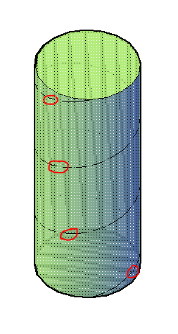

I'm working in 3D to create models but to get the dimensions right I'm creating the centre lines and then sweeping the shape around it to form the solid.
I've created an arc in one plane, however I now want to 'bend' the arc around a cylinder. I've attached a drawing to make it all a bit clearer, I want to bend that arc around the green cylinder.
Any suggestions how best to do this?
Thanks in advance!
bend_it.dwg

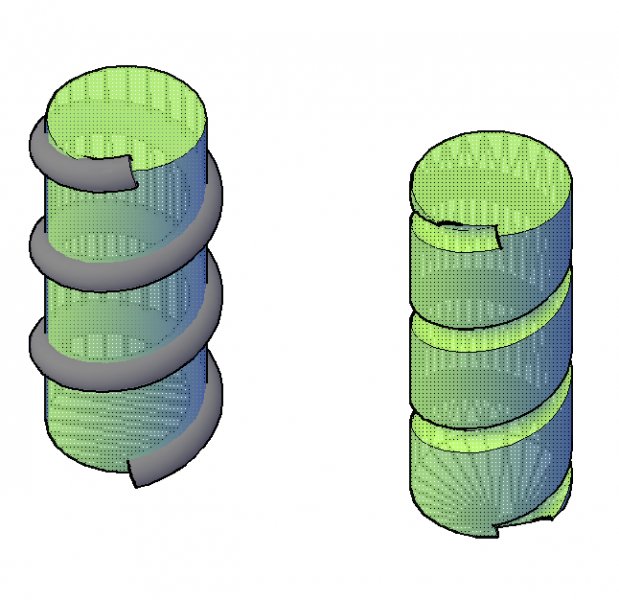

I believe what you are trying to do is a HELIX.
Still not really following your intentions.
Enter HELIX at your commandline, and follow and explore the prompts.
After you create a helix you can alter many of the properties to modify
its attributes.
Once created it can be used as a sweep path to create a 3D Solid.
Your arc is not in contact with your cylinder. Not sure if you are aware of that or not.
Is this what you had in mind? This was done using the Helix command as suggested by Dadgad.
Cool thing you can do with your helix. Sweep a circle along the path of the helix then subtract it from the cylinder.
