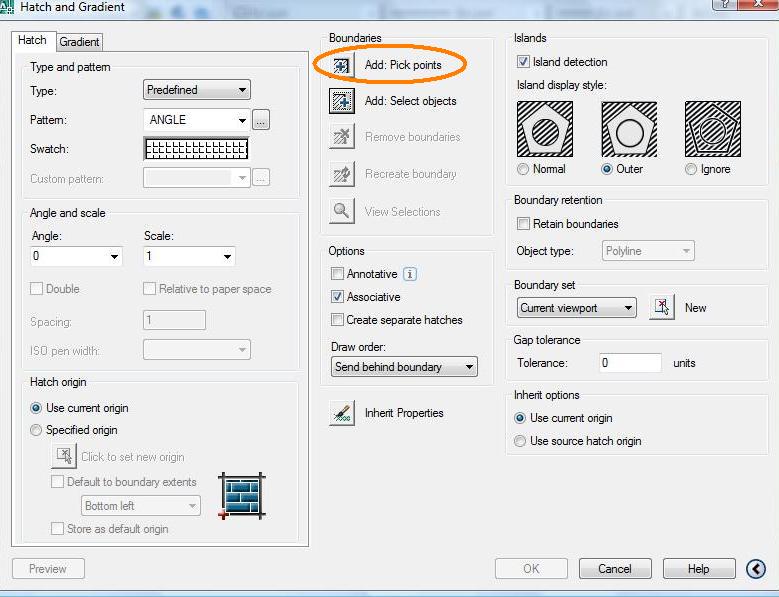

hatching help ??
ok was asked to start a new thread and thank you for your advice in my first thread, gonna read it thoroughly but still abit stuck.
ill up load what im trying to achieve so someone can say which method is best? ( i need to replicate these plans basically what iv uploaded.
the REAR elevation is the one im truly stuck on, the roof work and the brick work i need to replicate that.
any NEWBIE easy to follow rules would be great.
cheers guys

You want to draw these pdf's in AutoCAD?
Do you have dimensions to work with?
The hatch patterns for the brickwork and Spanish tiles should be available in AutoCAD. So, what is the exact nature of your problem?
yes there on a 1:1 scale in mm, i printed them out and measured them and im in the process of doing them.
just hit a snag with hatching. think im getting there but when i put the brickwork in it goes over my window frames. so i need to figure out how it misses out goin over them. if you know what i mean???
Hi. When you are picking the boundary for your hatch make sure you use the 'Pick Points' option from the hatch dialogue box (see below). Then pick a point inside the wall but outside the windows. I'm guessing you used the 'Select objects' option and picked a point on the wall boundary itself
i want to have your babies thank you mate!!! that did it
