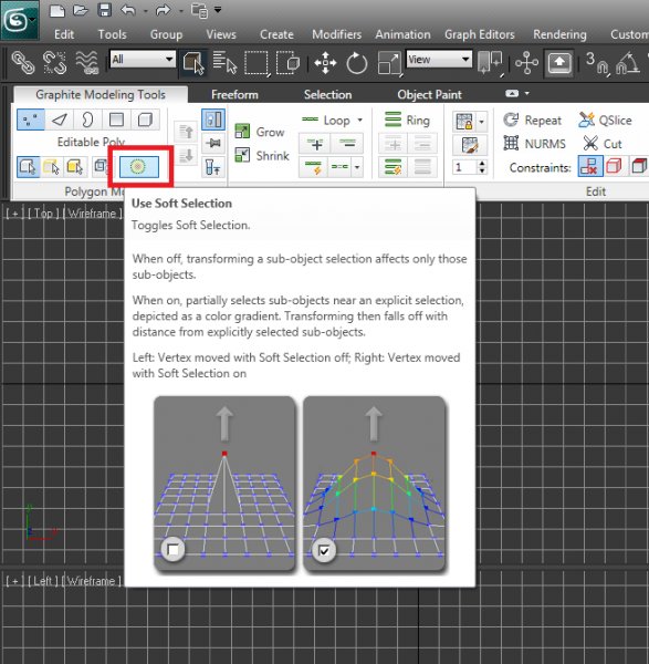

Rewind23 Posted August 10, 2013 Posted August 10, 2013 @StyK - just a thought..Maybe might work..Try the "Use Soft Selection" this is under the Graphite Modeling Tool.With this, you can have the control of which vertices you wanted to move/adjust to get the curve for the "dip" I dont know too the right term for that. Quote
tzframpton Posted August 10, 2013 Author Posted August 10, 2013 WOW!!! That is an awesome tip!! I can get used to this function. Thanks a ton Rewind, much appreciated. I'll see how well I do with this option. Since you've posted I've been scrolling through the Help file and looking at other modifiers too and it's just crazy how easy it is to manipulate 3D objects in this program. Quote
