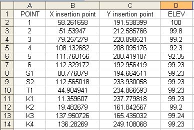

Not taking anything away from the lisps, but look what I got using the inbuilt Attribute Extraction
and in the T1 block as posted there is no description "tree".
The Excel spreadsheet has only to be saved in .csv format, so the data has commas separating the data.

Use the Attribute Extraction tool. All that you want is available there, and in this case, lisp seems to be not necessary.
I use EATTEXT but the lisp is faster.
I need to add (,) between them not space and i want to have the option to choose the path of the txt export file is it possible. How can i do it ?
And this is what the data looks like, with a column for description.
POINT,X insertion point,Y insertion point,ELEV,DESC
