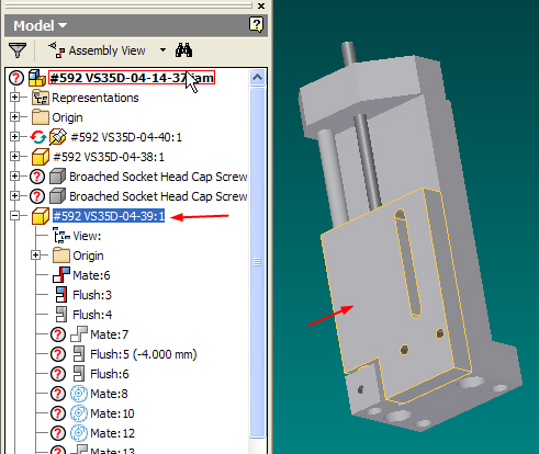

Cannot move component in assembly
I cannot move the part in the assembly, even though i suppress the constraining mate, and all other mates too, and uncheck adaptivity

Turn off Adaptivity (see first part in browser).
Why are you using Adaptivity rather than multi-body solids (much easier for a beginner)?
You assembly won't work anyhow as you haven't left any clearance for motion and manufacturing tolerance.
At home it works, the files that i sent.
I made another position representation, and in that representation the adaptive option is greyed out in both, the first part and the part that i want to move
