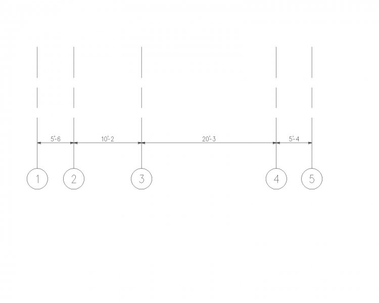

Jason in Atlana Posted August 20, 2013 Author Posted August 20, 2013 This is what I want to accomplish *faster* (pictures being worth 1,000 words): Quote

Dana W Posted August 20, 2013 Posted August 20, 2013 This is what I want to accomplish *faster* (pictures being worth 1,000 words): [ATTACH=CONFIG]43550[/ATTACH] OOPS, I read too fast. I had thought your copymode was not working the way it should. Yeah, the non-repetitive distance is difficult. The other guys seem to be going down a couple of decent pathways though. Quote
