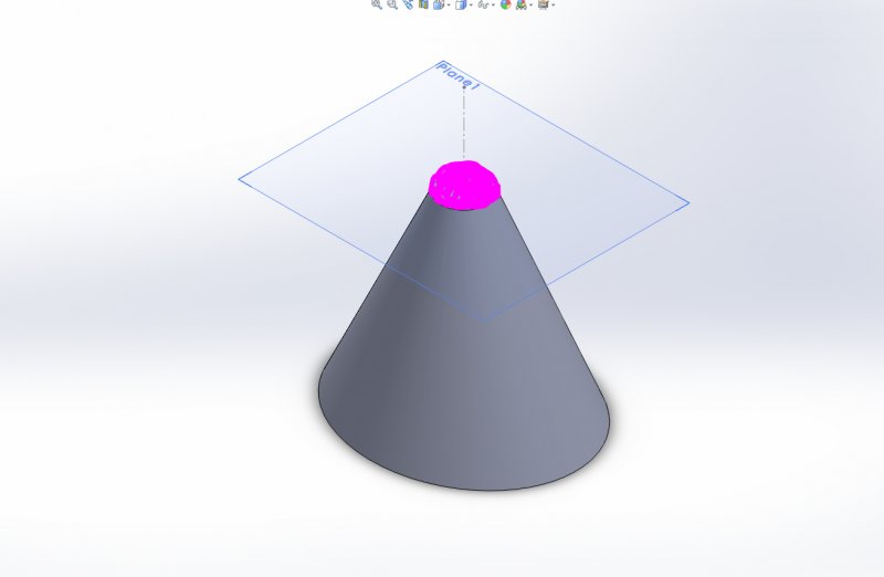

I want to make a solid like a cone, but the base doesn't have to be a circle but an elipse. How can I make that happen? I tried many things but still not succeeded.
Thanks for reading, hope someone can help me out.
Below a screenshot of what I want to achieve...
Loft will be your solution.

The lofted Boss/base works. But only half. I figured out how it works with planes in solidworks, but how do I attach the top? there must be a reference to the top and the revolve or the plane right? Or do I have to make an other plane on top of the other two?

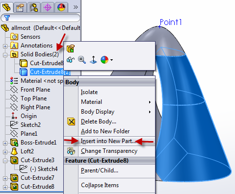

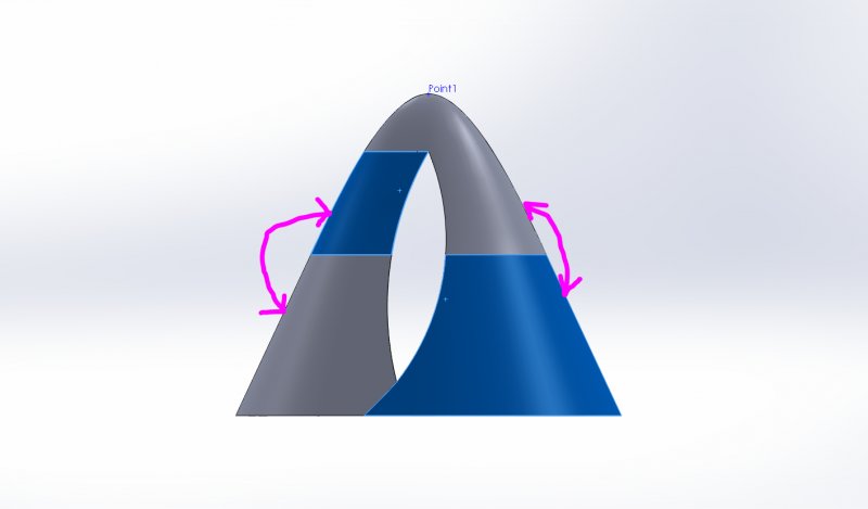

Next problem I come across is this: I made some extrude cuts and now ending up with 4 solid pieces, since I edited your last version. It should be two pieces and I want them seperated (a left and right piece) see attached file and screenshot
allmost.SLDPRT
I typed out a bunch of information and somehow lost it all.
See the attached image and let me know if you can't figure it out.
Right click....
Got it, thank you so much.....I learned a lot!
