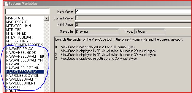

The value shown in the SYSVDLG image describes the available options, and you want to set it to 0.
