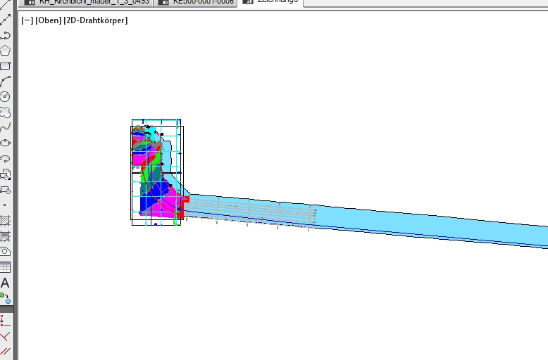

nazerrul Posted August 22, 2013 Posted August 22, 2013 (edited) Hi Guys! I am very new to AutoCAD Civil 3D, and i am encountering some problems with my client supplied data. The client had supplied me with a DTM file (as per attached Dalak_ASCII_BRSO.xyz) to be the input in AutorCAD Civil 3D, however, when i insert the DTM, the terrain only appears dotted. Is there any way i can convert the points into a 3D terrain model? For the time being, i am trying to figure out how to convert a topography drawing into 3D digital terrain. Attached is the example of the drawing. P/s : I am not coming from civil background. I know next to nothing about land surveying and this stuff. Seeking help! Edited August 22, 2013 by nazerrul update Quote

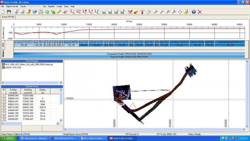

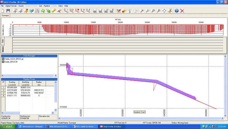

nazerrul Posted August 23, 2013 Author Posted August 23, 2013 What points are you talking about? If it is the ones in the 'Bathy1' bathymetry survey block, then they do have z values and you could create a surface from them.'JA bathy' block, which looks like a detail survey, doesn't have points. You won't be able to create a surface from this data. Thank you Organic for your reply. I may need some times to get familiar with all these terms Frankly, i dont know what do these points represents. We got the raw data from our client. The .xyz supposedly be the input for the a SAGE Profile 3D software. But when i mount the input, the software only shows dotted terrain instead of solid. Attached are the snapshots of the one im having the issue of, and one that works fine. I had tried playing around with the raw data, but still end up failing. Here is the raw data : https://www.dropbox.com/s/qr4yrbrnw9mxf9i/130726%20Dalak_ASCII_WGS1984%20-%20160813.xyz Quote

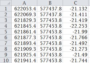

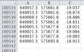

eldon Posted August 23, 2013 Posted August 23, 2013 (edited) Well here is the start of the file, and the end of the file (Dalak_ASCII_BRSO.xyz)as I see it. Can you explain it Edited August 23, 2013 by eldon added file name Quote
eldon Posted August 23, 2013 Posted August 23, 2013 The OP has posted two data files, and I was looking at the earlier one, which seems to have more data than the second one. Quote
Emigrato Posted August 23, 2013 Posted August 23, 2013 In my 'beware' post, I was talking about RAW DATA while you refer to cleaned, postprocessed ones, sir. Quote
