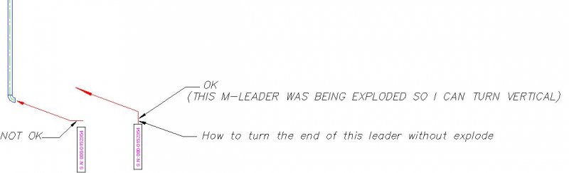

Does anybody know how to make Muti Leader end line landing or turn 90 degree vertical? I just want to use the leader point to the part and no text at the end of the leader. I guess the only way i know how to do right now is to exploded the M-leader and draw a line vertical down which is not reall proper way, please help. Some people like to use just Leader not Muti leader but i like to use M-leader so i can enter the text in difference line. Please help. (See Pic below)

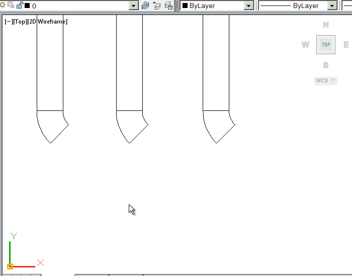

My first suggestion is to rotate the UCS
or
Rotate the whole MLeader (without Exploding)
or
Change/Create a MLeader style with 3-point leader, no Automatic landing, and "As Inserted" text orientation.
or
Use a QLeader
All 3 methods using MLeaders shown below from most preferable... to least, IMO

[ATTACH=CONFIG]43609[/ATTACH]
i got it now, i like the last Method, very easy. thanks so much
