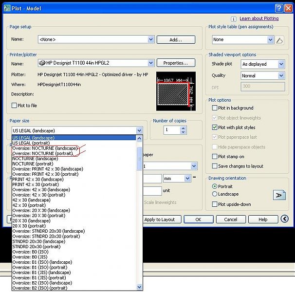

you will need to toggle the orientation of the paper as portrait or landscape orientation in your plot settings. under paper size, the paper orientation you choose here is how the paper will come out on the plotter.
in your case w/c you say is going the long way,,, set the paper orientation to landscape
Also match your Drawing Orientation to landscape also to match the paper orientation.
On our Plot dialog box there is a check box for autorotate. It works well -except when there are raster images in the dwg.
