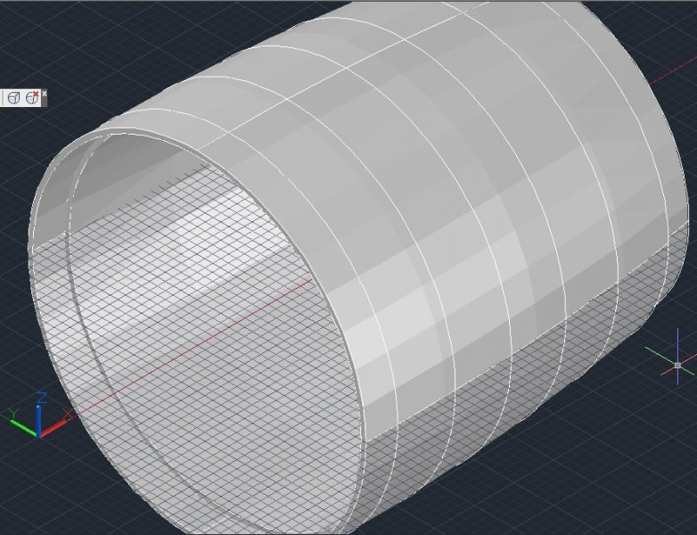

turboCAD Posted August 26, 2013 Posted August 26, 2013 Hello! I used 2 3d printers to print the same object(a funnel with a circular section): Makerbot replicator 1 and 2.The result was a shape which was not circular in section but polygonal. What can I do (or the owners of the 3d printers) in order to obtain a circular form? Initially I thought it was displaying it as a polygon (”shade” command) to save memory usage but when the actual product turned out non-round I concluded that I (or the owner of the printer) may be doing something wrong. Thank you! palnie3.1.dwg Quote

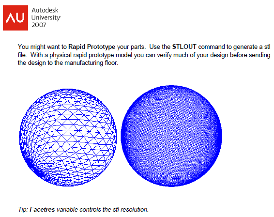

JD Mather Posted August 26, 2013 Posted August 26, 2013 ... What can I do (or the owners of the 3d printers) in order to obtain a circular form? Viewres = 20000 Facetres = 10 RE then stlout. There are a bunch of other tips at the link at bottom of my post. Quote

JD Mather Posted August 26, 2013 Posted August 26, 2013 Keep in mind the stl files are by definition planar faces - so this simply increases the facets. I thought there was another settings box in AutoCAD for more stl control - but I can't find it now. Autodesk Inventor has a dialog box that allows more control. Quote
turboCAD Posted August 26, 2013 Author Posted August 26, 2013 I did not know that .stl files are planar faces but that explains the outcome. So, if the drawing had an outer circular surface that contained N individual points, the maximum achievable resolution would be N/3 faces because 3 points are the minimum requirement for a plan. Judging by the apparent* improvement generated by all the measures that you kindly suggested (once again helping me and others having the same problem) I don't know if such a high resolution is possible N/3; if possible, this level of approximation would make the transformation 'circular-> sum of plans' unnoticeable. *by apparent I mean I did not reprint the part to verify its roundness but to my eyes, the object after shading, appeared smoother.I don't know how to verify what the printer would "see" . Quote
JD Mather Posted August 26, 2013 Posted August 26, 2013 Increasing the number of facets decreases their size and increases their number. The part gets smoother (rounder). At some point the resolution of the stl file is greater than the resolution of the printer. The resolution of the printer layers becomes the limiting factor (the part will show "stair-stepping"). Better printer resolution = more $$$. Quote

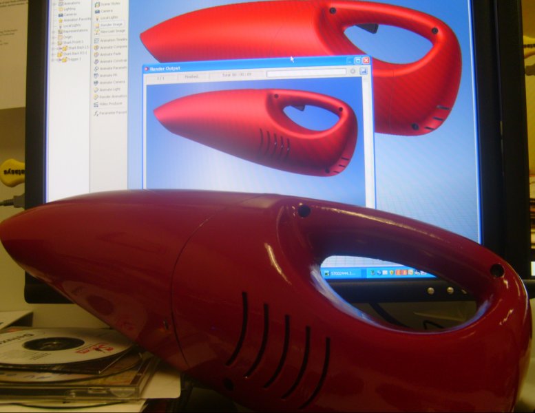

JD Mather Posted August 26, 2013 Posted August 26, 2013 A trick that I use is to coat the model with dry-wall compound (not sure what you would call it - a soft plaster). Sands very easy. recoat and repeat sanding Spray paint. Quote
turboCAD Posted August 27, 2013 Author Posted August 27, 2013 Lovely finish! I need it to be as smooth as possible to create little turbulence so I was thinking of painting it with hydro-isolating paint (the piece is made out of three smaller ones because it would not fit in the printer as a whole) in order to prevent air leaking at the joints. I don't know if paint alone, without primer, will dissolve the plastic. I have to document that. Quote
