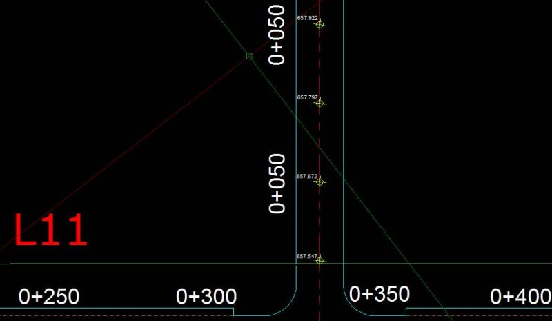

INVERT LEVEL:-
(Enter First IL – Enter Second IL /Enter distance*Enter distance of new IL) ± Enter Invert Level First or Second.
First IL=657.922 Second IL=657.672 Distance=50
(657.922-657.672/50)*25
=(0.25/50)*25
=0.005*25 = 0.125
=0.125+657.547 = 657.672
You might need to provide additional details, what you have there is hard to follow.
check this jpg i have only one level so calculating this any lisp have please suggest me
The best way would be to draw manholes at exact location then enter slope or rise/fall this way it works out the correct answers.
Pick first manhole and enter invert and slope, pick next manhole, invert label will appear based on some rule re angle of two points.
Is this what you want ?
i am looking for lisp selecting two levels calculate then i pick a point then give value
example see jpeg first i know two points one 657.547 and second 657.922
Your dwg has Z values?
Do you intend to select the TEXT or the POINT entity?
In your image the POINT and TEXT, are two separate entities or a block?
Do you intend to calculate always straight, or with curves?
There are too many questions, the best way to manage to get help, is helping us, attaching a sample drawing with what you have and what you intend to get...

A quick and dirty one, works in WCS only... Try it...

Thank you hmsilva
Look this lisp calculate level this is ok but I need same formula but I pick the point where I need to calculate paste insert text continues this lisp giving only one time prompt window
I want click next point where distance then continues click then give value click then give value
