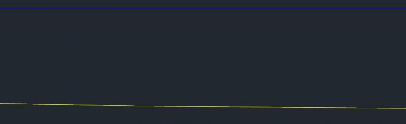

Steven29410 Posted August 28, 2013 Author Share Posted August 28, 2013 Concerning the length, yes that is exactly what I meant, thank you to reformulate it in a better way. My expression in english is not crystal clear yet ^^. About the drawings, as It is a school project in partnership with my teacher's laboratory, I am not sur I am allowed to attach the whole file. I have attached a snapshot of a small part of the line. Quote Link to comment Share on other sites More sharing options...
Steven29410 Posted August 28, 2013 Author Share Posted August 28, 2013 What I need exactly is the distance between the bottom yellow curved polyline representing the seabed and the blue straight line representing the sea level with a fixed horizontal interval of 2m. But if I get the Y coordinate it is okay, I will just need to minus it with a constant value after. Thank you Quote Link to comment Share on other sites More sharing options...
Steven29410 Posted August 28, 2013 Author Share Posted August 28, 2013 I think I have finally found a way to do it : First, I create a vertical line every 2m then I found a lsp to automatically create points at intersection between objects. Finally I found another lsp which extract the point coordinates of a drawing in a txt file. Sorry for the inconvenience, thanks for your help. Quote Link to comment Share on other sites More sharing options...
