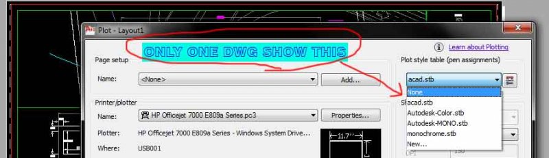

Help me Pen assignments problem
I have pen assignments CTB formats but one dwg. Not show CTB files only show STB files how to fix this problem please help me
Only one dwg not show ctb pens
Could it be that the printer is listed twice and each listing has its own style? See how one printer name ends in .pc3 while the other one doesn't?
Another option: the CONVERTPSTYLES command.
thank you ReMark CONVERTPSTYLES is working thank you so much
