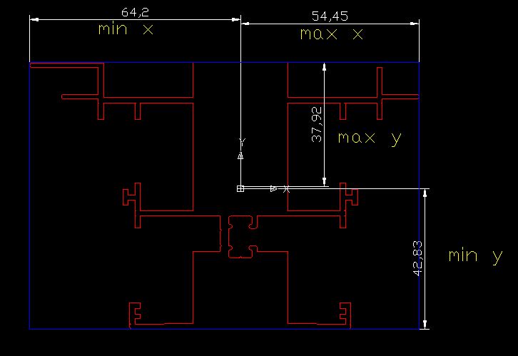

Is it possible to find max x and minus x from polyline ?
If I don't learn something new (or two somethings) a day I feel as though I wasted my awake time so tell me what is "max x" and "minus x" and just what it is you are going to accomplish by obtaining that information?
Are these polyline coordinates you are attempting to retrieve by some lisp code?
Could it have something to do with polyline vertices?
Capture.JPG I want make retangle in lisp whith max et min xy.
We seem to be stuck. Let's give this thread a *bump* and see what happens.
This probably needs to be in the LISP forum, doesn't it? I'm not clear on how you are inputting the info from a polyline. I can tell you that 'min' here should mean minimum (not minus), comtrasted with max for maximum. The values seem to be reversed in both cases shown. Perhaps more explanation is in order as well.
.... The values seem to be reversed in both cases shown.
Looks right to me. A negative is less than a positive.
I know in some of the CAD programs I use they will return the bounding box x,y (and z) that irregular geometry would fit into. But I have no idea of the code for retrieving this information.
BTW - without your picture I would have had absolutely no idea what you were after.
I think I found what I want but the code is create in 1998.

For straight-segmented LWPolylines:
(defun c:bbpoly ( / e l )
   (if (setq e (ssget "_+.:E:S" '((0 . "LWPOLYLINE"))))
           (setq l (mapcar 'cdr (vl-remove-if-not '(lambda ( x ) (= 10 (car x))) (entget (ssname e 0))))
                 l (mapcar '(lambda ( x ) (apply 'mapcar (cons x l))) '(min max))
           (entmake
               (list
                  '(000 . "LWPOLYLINE")
                  '(100 . "AcDbEntity")
                  '(100 . "AcDbPolyline")
                  '(090 . 4)
                  '(070 . 1)
                   (cons 10 (car l))
                   (list 10 (caadr l) (cadar l))
                   (cons 10 (cadr l))
                   (list 10 (caar l) (cadadr l))
For multiple straight-segmented LWPolylines:

I use this very often to find limits of a point list and the overall x & y size:
(defun plimits (l)
 (setq mnx (apply 'min (mapcar 'car l))
       mxx (apply 'max (mapcar 'car l))
       mny (apply 'min (mapcar 'cadr l))
       mxy (apply 'max (mapcar 'cadr l))
       ysz (- mxy mny)
       xsz (- mxx mnx))
For your needs, you would feed the point values from the LWPOLYLINE entities to the call:
It's a starting point. -David
