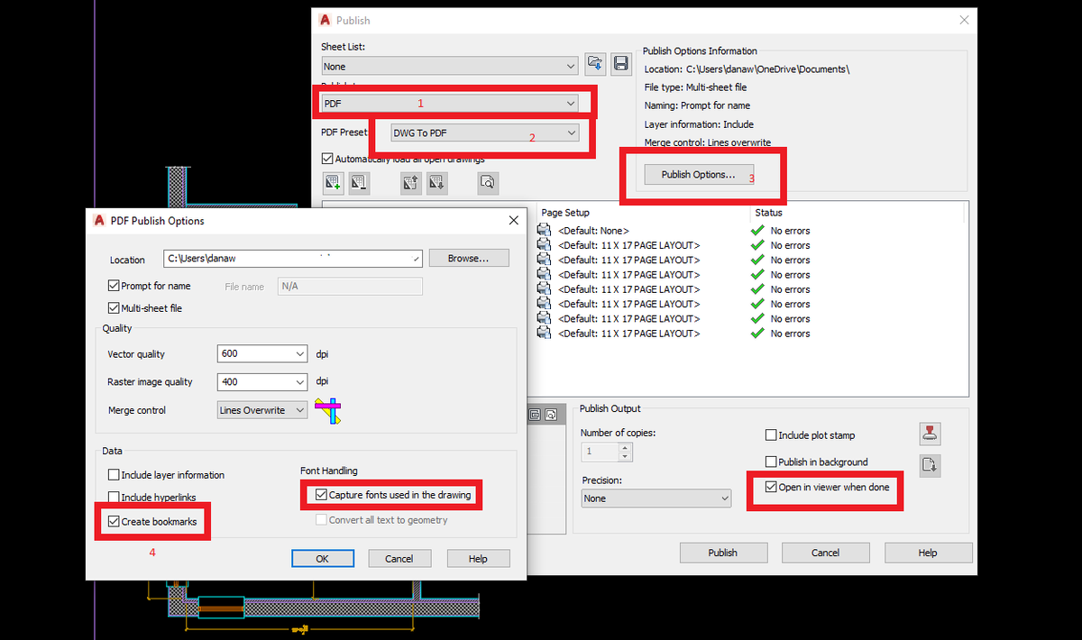

Dana W Posted January 1, 2021 Posted January 1, 2021 (edited) Skip Bluebeam. The dwg to pdf pc3 in 2021 is pretty good. I don't know why you are getting a raster or black wipeouts, but as far as the bookmarks, it's right here, click the Publish Options button after selecting box 1 and 2 on the Batch Plot dialog. Check all the boxes shown. Without the right pdf boxes checked it won't show the data section of the Publish Options dialog box. You can check the Include layer info if you like but it bloats your pdf file. The res quality is up to you. The lines above PUBLISH OPTIONS have not updated because I have not clicked OK and this is the first time I have used AutoCad on this machine, my new hotrod. Oh, and Lines Overwrite leaves gaps where lighter is over darker so I use Lines Merge instead. Just thought I'd mention that. I fixed it after saving the png. Edited January 1, 2021 by Dana W Quote
