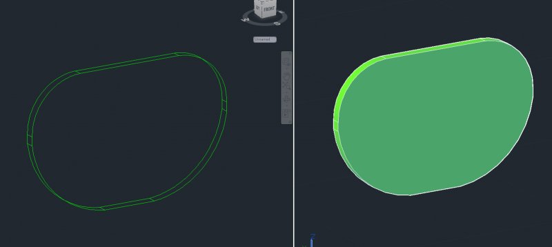

There is no similar (bend modifier) in AutoCAD.
Construct the curved piece (as a blank) then punch through it with an extrusion of your chair back profile. Use the INTERFERE command to derive the final shape.
Crude (I know) but this will give you a rough idea of what I'm talking about.
aaah thanks see the pictures now. Great will try :D
