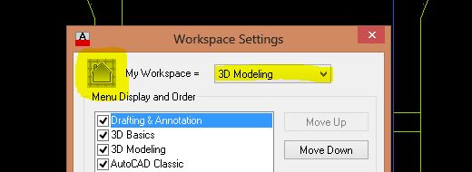

Dadgad Posted September 21, 2013 Posted September 21, 2013 Welcome to CADTutor. You SAVED your workspace, and set it as your HOME workspace? Quote

Dadgad Posted September 21, 2013 Posted September 21, 2013 AutoCAD should restart in the same wordspace that was active when AutoCAD was last closed. Perhaps there's something in the startup routine or a WS switch in the shortcut? "Home workspace"? I think I'm about to learn something new... teach me. In your workspace settings dialog, as shown. Quote

maheshchandwadk Posted September 21, 2013 Author Posted September 21, 2013 Yes. even i restart my pc and started again autocad as per your instruction in image but still it is reapeting with drawing and annotation wayo:) Quote
nestly Posted September 21, 2013 Posted September 21, 2013 In your workspace settings dialog, as shown. Hmmm... I've never changed "My Workspace" so it's still Drafting and Annotation in all my versions (AutoCAD2011-2014) But I never actually work in that workspace. My AutoCAD has always launched the same workspace that was active when it was closed. Ditto for all the vertical flavors. So I changed it, closed and relaunched and it still opened in the previous workspace, not "My Workspace" so I'm not sure what that's supposed to do? Quote
Dadgad Posted September 21, 2013 Posted September 21, 2013 (edited) Hmmm... I've never changed "My Workspace" so it's still Drafting and Annotation in all my versions (AutoCAD2011-2014) But I never actually work in that workspace. My AutoCAD has always launched the same workspace that was active when it was closed. Ditto for all the vertical flavors. So I changed it, closed and relaunched and it still opened in the previous workspace, not "My Workspace" so I'm not sure what that's supposed to do? I don't pretend to know THAT it does something, I merely know that it is an option presented in the worspace settings dialog, and I routinely set my prefered workspace to be my home workspace, although from what you are reporting it may not actually do anything, which begs the question, why do they present the option? Edited September 22, 2013 by Dadgad Quote
nestly Posted September 21, 2013 Posted September 21, 2013 If you start AutoCAD from a shortcut, check the shortcut properties. If there's nothing unusual there, try editing the shortcut per these instructions Startup Switches for AutoCAD If you don't start AutoCAD from a shortcut, or the Startup Switch doesn't work, then perhaps explore the acaddoc.lsp file. Quote
Dana W Posted September 21, 2013 Posted September 21, 2013 (edited) Make sure the workspace you want to use is "Moved Up" to the top of the workspace list in the dialog Dadgad displayed earlier. That helps, at least emotionally, it helps. I once had a similar problem at work several years ago. Turns out the Drafting Coordinator would make the rounds of the 4 drafter's computers on Saturday and check drawings on the C drives for progress. He would switch workspaces on us because he liked the ribbon. Of course, the ribbon would come up on Monday morning. This guy trusted no one, ever. Yet, he always left his keys out on his desk all day. I wonder if he ever figured out who re-programmed the default of his car's memory positions on the power seat. He was only 5'-6" tall. When he got in his car one Friday night, the seat slid all the way back as far as it would go. That's almost 18" in a Crown Victoria. Edited September 21, 2013 by Dana W Quote
