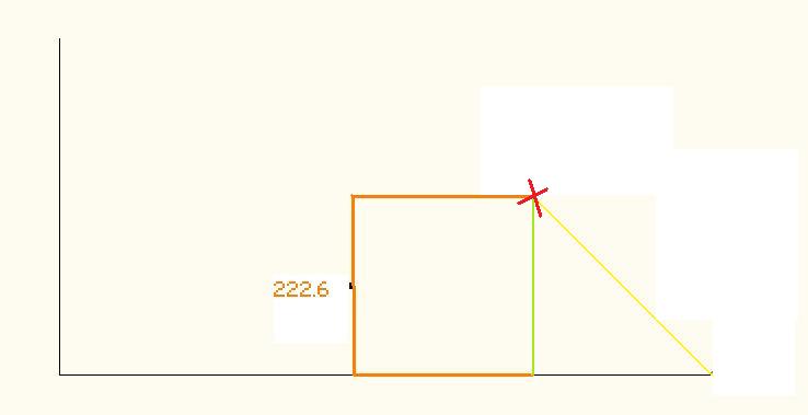

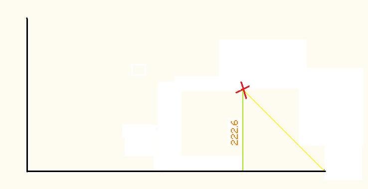

Portmanteau Posted September 21, 2013 Posted September 21, 2013 (edited) Hi, I was hoping someone might be able to help me. I am trying to replicate a drawing created in Vectorworks in AutoCAD ('09). I am only a beginner with AutoCAd & I'm having difficulty replicating a step from this video: http://www.lboro.ac.uk/departments/sota/IT_tutorial_web_site/vectorworks/aaltoChairProject/vectorworks_aaltoChairProject_02.htm ;in AutoCAD. Here is what I have done so far but the measurement outlined in the video isn't being replicated in Autocad. The line measured in Orange should be 222.5 from the horizontal line to 45° line but, it's coming up as 222.6 in Autocad. What am I doing wrong? Thanks in advance. Edited September 21, 2013 by Portmanteau Quote
Dana W Posted September 21, 2013 Posted September 21, 2013 Hi, I was hoping someone might be able to help me. I am trying to replicate a drawing created in Vectorworks in AutoCAD ('09). I am only a beginner with AutoCAd & I am difficulty replicating a step from this video: http://www.lboro.ac.uk/departments/sota/IT_tutorial_web_site/vectorworks/aaltoChairProject/vectorworks_aaltoChairProject_02.htm ;in AutoCAD. Here is what I have done so far but the measurement outlined in the video are not being replicated in Autocad. [ATTACH=CONFIG]44094[/ATTACH] The line measured in Orange should be 222.5 from the horizontal line to 45° line but, it's coming up as 222.6 in Autocad. What am I doing wrong? Thanks in advance. You are not doing anything wrong, It appears that the line in question is not perfectly perpendicular, assuming that geometry is supposed to be a square.. This could account for it being 0.1 too long. That means the adjacent lines are not accurate either. Converting vectorworks drawings to AutoCAD is pretty much a challenge for everyone. The geometry doesn't always come out very accurate. They have to be "dressed up" a bit. Quote
Portmanteau Posted September 21, 2013 Author Posted September 21, 2013 Hi Dana, thank you for your reply. The geometry is not a square, in fact it's a 222.5 green line that is supposed to intersect the 45° but, it will only intersect at 222.6. Very annoying Quote
mikekmx Posted September 21, 2013 Posted September 21, 2013 Hi Dana, thank you for your reply. The geometry is not a square, in fact it's a 222.5 green line that is supposed to intersect the 45° but, it will only intersect at 222.6. Very annoying the line's properties state it is 222.6? your dims may be rounding up. (i haven't downloaded the dwg as no cad on this pc) Quote

JD Mather Posted September 21, 2013 Posted September 21, 2013 .... green line that is supposed to intersect the 45° but, it will only intersect at 222.6. Green line can intersect the 45° at an infinite number of points - it is up to you to set it at the 222.5 point. (I was able to easily do it.) Attach your file here. Quote

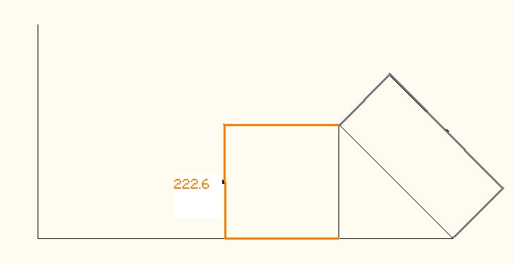

nestly Posted September 21, 2013 Posted September 21, 2013 (edited) I believe the tutorial is either wrong or misleading, 810.8 (Base line length) minus 588.2 (start of vertical line from the origin) equals 222.6 therefore the vertical line must also be 222.6 in order for the angled line to intersect at a 45 degree angle. Perhaps the line angle isn't supposed to be exactly 45 degrees, but then that begs the question why he initially made it 45? I never used Vectorworks, so perhaps that's a logical workflow for Vector, but IMO that's not even close to how I'd do it in AutoCAD. *Edit.. upon further review, the dimensions are not accurate because his drafting technique are ... ummm... not very good. Edited September 21, 2013 by nestly Quote
Dana W Posted September 22, 2013 Posted September 22, 2013 Hi Dana, thank you for your reply. The geometry is not a square, in fact it's a 222.5 green line that is supposed to intersect the 45° but, it will only intersect at 222.6. Very annoying [ATTACH=CONFIG]44096[/ATTACH] OK, then, the orange line is a dimension? I saw the pixilation in the orange line and went with that. You have experts here now. See ya. Good luck. Quote

nestly Posted October 26, 2013 Posted October 26, 2013 What are you seeking assistance with, the original drawing (chair) or the "cross table"? I'm not even sure where to start with the "chair" because the guy demonstrating how to draw the chair is so sloppy. For starters, when he pulls the 45 degree line back to the 222.5 vertical line, he pulls it back to what appears to be an extension of the vertical line, not the actual endpoint of the 222.5 vertical line. Your observation that the lines do not intersect when one leg is 222.5 and the other is 222.6 is correct, but the guy seems oblivious.... this is typical of other drafting inaccuracies made throughout his demo. I can show you how to do it in AutoCAD, but since his reference drawing is not correct, I'd have to make some assumptions. Quote
