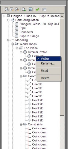

nestly Posted September 27, 2013 Posted September 27, 2013 When modifying an existing part, visibility is turned off by default for everything (workplanes, geometry, dimensions, profile, paths, connectors etc) and it's a tedious process to click through each item and turn it on. Is there a way to make everything visible globally? also, I don't understand why Slip on flanges don't have a deflection value since they're pretty much the ultimate solution for misalignment in the realm of steel pipe. Thanks Quote
tzframpton Posted September 27, 2013 Posted September 27, 2013 Nestly, I have never found a way to globally enable the non-visible items in the Content Builder. Most MEP guys have often said this editor seems ancient needs a fair amount of updating. In functionality it's not very ancient, since it fundamentally works exactly like Revit with Work Planes, Profiles, Geometry Modifiers, Connectors and Parameters/Constraints. The interface of these tools, however, do seem a bit redundant and simplified. As for deflection... is this a parameter you are inquiring in how you can add yourself? Or were you just generally commenting on the OOTB content? Quote
nestly Posted September 27, 2013 Author Posted September 27, 2013 Thanks for the reply Tannar. I sort of figured there was no way to turn the visibility on independent of how it was saved, but I was still hoping.... Re: Deflection, the latter. The main reason to use SOF is to correct minor misalignment, so it seems odd that OOTB SOF's do not have a deflection tolerance, especially considering OOTB Socket Weld flanges do. I also don't understand why OOTB Slip On has a CEL2 = 0. In real life, SOF's are intended to slip onto the pipe/fitting, and you can normally slip a LR elbow at least half way into a SOF and still maintain 90 degrees. It seems that having the CEL=0 and indexed off the hub side causes SOF's to insert flush with the hub face, and prevents an elbow from being inserted more than 1/4" (the length of the straight section of the path on an elbow). I'm trying to figure out if SOF's are built like that for a reason, or if they're just built carelessly? Quote

nestly Posted September 30, 2013 Author Posted September 30, 2013 Thanks for the suggestion hertz hound. I decided to start learning to build parts with something easier first (threaded and socket weld elbow/tees) before trying to put holes in stuff. I ran into another snag however. Once a parametric part is inserted into a drawing, I can't get the changes made in Content builder to update the part. I've tried Regen'ing the catalog, open/close the drawing, and using OBJRELUPDATE, but the part will not update unless I purge it out of the drawing and re-insert. Any ideas? Quote
hertz hound Posted October 1, 2013 Posted October 1, 2013 I know exactly what you mean, but I don't have any ideas. I am very used to trying out the part in a new drawing and closing the drawing without saving changes. Modifying the part and trying it again in a new drawing. The same thing happens with block based parts for me. Until the old one is purged it keeps inserting the old block definition. The real weird thing is, (unless it is me) sometimes the part will show the update without a purge. Quote
nestly Posted October 4, 2013 Author Posted October 4, 2013 I got some help on updating parts at the Autodesk forums REDEFINEFROMCATALOG (also on the Ribbon > Manage > MEP Content pull-down menu) Quote
