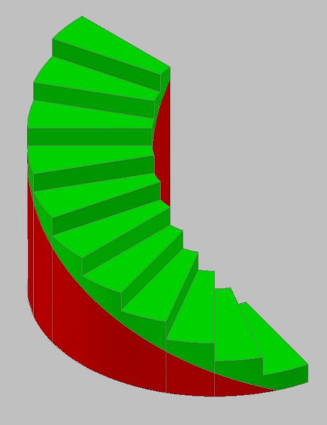

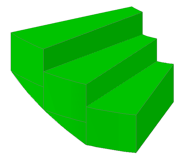

ReMark Posted September 30, 2013 Posted September 30, 2013 My attempt thus far resulted in something along these lines. Would that work for you? Quote

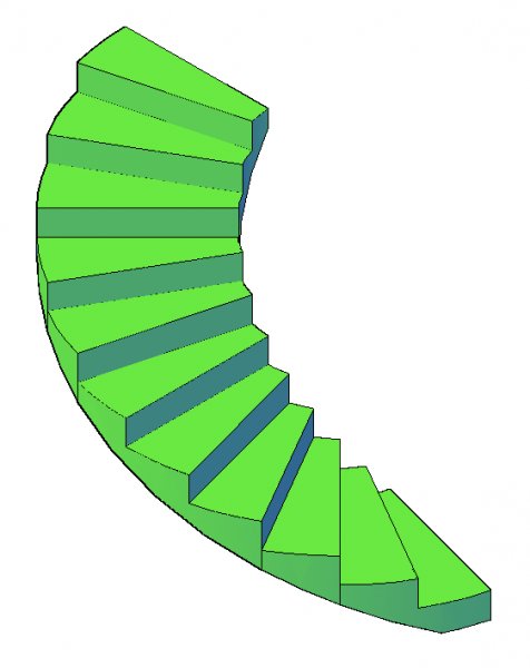

ReMark Posted September 30, 2013 Posted September 30, 2013 I may have worked it out. Probably not with as much finesse as JDM however. Quote

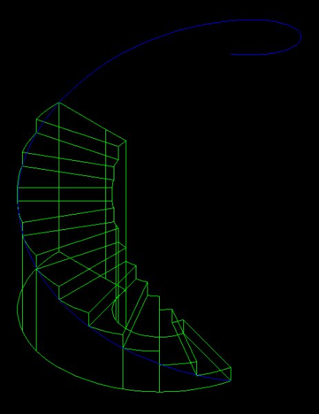

ReMark Posted October 1, 2013 Posted October 1, 2013 (edited) Do this using a copy of your geometry. Visual style is 2Dwireframe. First. Union your steps so you have but one solid model. Edited October 1, 2013 by ReMark Quote

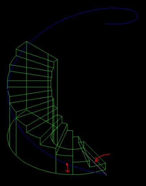

ReMark Posted October 1, 2013 Posted October 1, 2013 Second. Draw a line longer than the width of your stair. Mine (the white one in the image) was 1125 units. Locate the midpoint of this line on the midpoint of the bottom of your first step. This line, as JDM said, must overhang both sides of the stairs. Third. Reorient your UCS and move both the line you drew and your helix downward 120 units. Quote

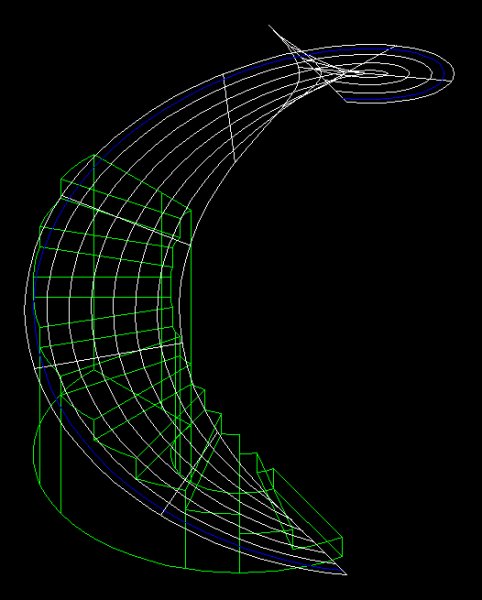

ReMark Posted October 1, 2013 Posted October 1, 2013 Fourth. Sweep the line you drew along the helix. Quote
ReMark Posted October 1, 2013 Posted October 1, 2013 (edited) Fifth. Use the SLICE command with the SURFACE option to slice the stairs. I kept both sides and changed the color of the lower portion to red so you can see it here (visual style is Realistic). This, along with your swept line and helix, is erased to achieve the final result as per the image I posted yesterday. Edited October 1, 2013 by ReMark Quote

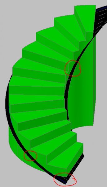

ReMark Posted October 2, 2013 Posted October 2, 2013 (edited) I used the helix that you provided and the only thing I did to it was move it down 120 units. The helix does not get a height. Look at the image below. See the three red circles? They show us that the line that was swept along the helix, to form the cutting surface, extends beyond the sides and below the bottom of our solid model. That surface is used to slice the stairs. Now it is your turn. Try again. Edited October 2, 2013 by ReMark Quote
