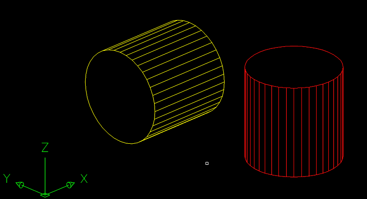

David Bethel Posted October 3, 2013 Posted October 3, 2013 For a circle with thickness ( extruded ), the image here, the red circle was constructed in WCS, In order to make the yellow circle, you must rotate the UCS. In this case the ucs would either be 1,0,0 or -1,0,0. -David Quote
JD Mather Posted October 3, 2013 Posted October 3, 2013 Maybe this will help. A circle is a planar entity. It can only be drawn on a plane. The UCS sets up the plane on which you want to draw your circle (or any profile). Quote
