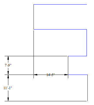

I actually thought to try it that way too using only the dimlinear command and then offsetting the dimension using the first text offset point but you can't keep using the first text point because the dimension will extend in the shortest distance to the point so you could end up with something as shown below. I don't know that I would run into this situation much but for the sake of it being versatile I want to prevent this.
