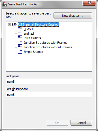

CivilPrice Posted October 23, 2013 Author Posted October 23, 2013 What is the US Imperial Structures.apc? What is the extension .apc When I am in the parts builder and I create a new part it will not allow me to save it??? Here is a screen shot. Do I need to create a new .apc file from the beginning in order to build my own parts list. ugh... this is wacky. I wish I could just have someone teach me this business, I know it is much easier than I am making it seem haha. But thank You Phil I am sure your input will be of great help once I can get all my pathing issues taken care of??? Quote
sandiegophil Posted October 23, 2013 Posted October 23, 2013 it looks like you're trying to overwrite an existing folder. at the top/left click the icon between the save and the cactus. this will open up the 'save part family as' dialog box. create a new chapter, give your part a name and description and it should be able to be used. Quote
CivilPrice Posted November 6, 2013 Author Posted November 6, 2013 You are the man Phil!! Thank You... I still get the error but it is saving my work??? I will probably have some more issues I will be bugging You about as well hahaha. Thanks Again!! Much Appreciation. Quote
