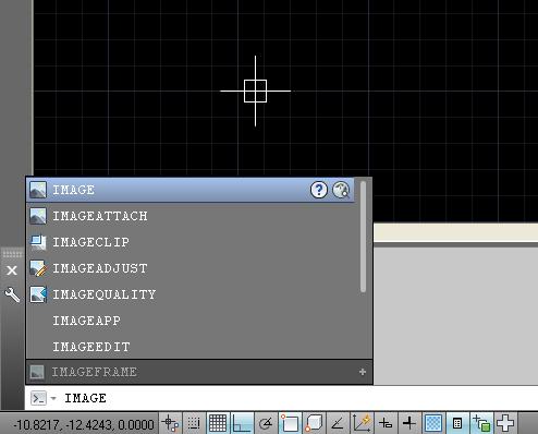

Hi buddy, I am also using Autocad 2014.
Try "command - imageattach' to insert image......
If you just type image in commandline you'll get couple of option to edit your image, which shown in below image....
[ATTACH=CONFIG]44728[/ATTACH]
