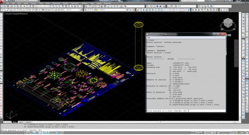

ReMark Posted October 24, 2013 Posted October 24, 2013 Visual style: 2Dwireframe. This is a simple visual of how the process goes from left to right. The final object on the right was created using the SLICE command to verify that I did indeed have a completely solid 3D model. Quote

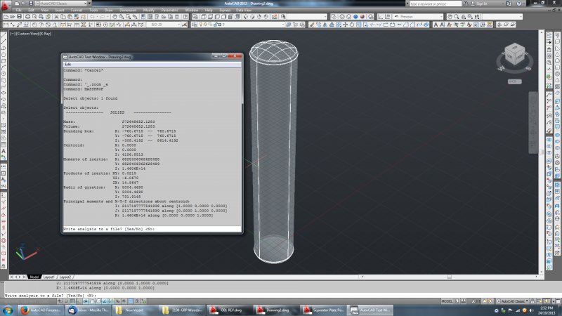

ReMark Posted October 24, 2013 Posted October 24, 2013 Visual style: Conceptual. The last two objects in the previously posted image. Solid through and through. Quote
