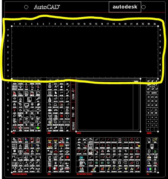

I have an old school fix for you. Buy a digitizing board and put your symbols across the top of it. Click on the symbol and it is ready to insert. That's the way we used to do it before the advent of tool palettes. Each menu area was capable of supporting 200 symbols.
Sample Tablet menu for digitizing in AutoCAD.
The area outlined in yellow is where one would pick. Each square would represent a particular symbol. Users would print these out with the symbols indicated in the square and place them under the clear plastic overlay of their digitizer.
