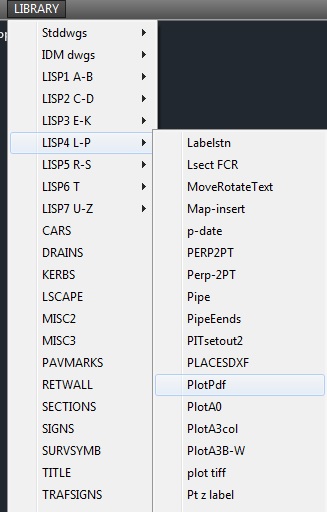

Like Tuns the only reason I didn't post a lisp solution which is a one button press is that you say you want different sizes printed or do you mean print in our case A1 & A3 we just have a separate button for each size. Search here for BIGAL & plotting there are many examples its an older post.
