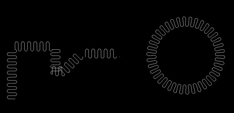

bustermin Posted October 30, 2013 Posted October 30, 2013 I am trying to create a custom lintype by using mkshape & mklinetype but I am not having any luck. below is a pic of what I am trying to make a linetype from. can anyone please help. Quote

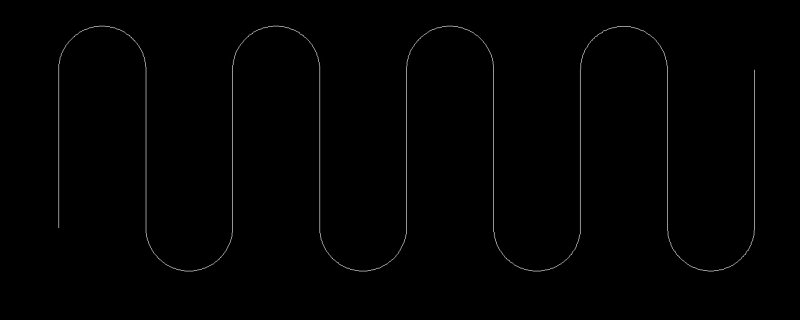

ReMark Posted October 31, 2013 Posted October 31, 2013 I was able to do it this morning (Thursday, 10/31). First I made what I called my "loop" out of two lines and two arcs. Next I used the PEDIT command to create one continuous polyline. I invoked the MKSHAPE command and just followed the prompts. I did a quick test to make sure I had created a shape by invoking the SHAPE command and inserting my loop. No problem. I invoked the MKLTYPE command, followed the prompts (using my loop "shape") and completed the task. AutoCAD created the linetype definition for me as expected. To test I opened the Linetype dialog window and made my new linetype named "Loop" current. I went back into my drawing and proceeded to draw a line and the result is as seen below. And to prove the above was not faked here is what the linetype definition file looks like. *LOOP,looped polyline A,0,-.000021,[TESTLOOP,C:\Users\mycomputernamehere\Desktop\Test,y=-.000022,s=1],-.498058 Quote

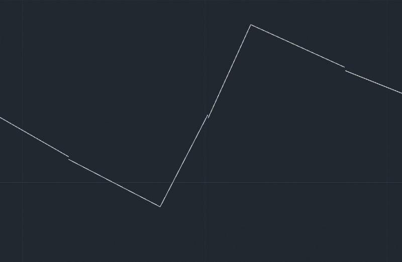

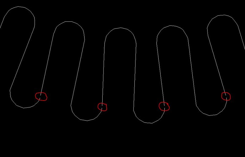

ReMark Posted October 31, 2013 Posted October 31, 2013 More proof. Got some not-so-good (totally expected though) results on the left. However, the results with the circle were totally unexpected. That came out really nice don't you think? Quote
ReMark Posted October 31, 2013 Posted October 31, 2013 Darn! Zoomed in on the circle and noticed the pattern breaks as it bends to form the circle. I would imagine that the tighter the bend the larger the gap would be and vice versa. The circle in the previous image had a diameter of 6. Oh well, it was an interesting experiment so it wasn't a total loss. Good luck getting your loopy line to work the way you want. Quote

bustermin Posted October 31, 2013 Author Posted October 31, 2013 That is the same procedure I was using and I can not get it to work, I got it to work one time but it had similar results to yours but the gaps were a lot worse. I am not sure what I am doing wrong.... Quote
ReMark Posted October 31, 2013 Posted October 31, 2013 And here I thought you hadn't gotten it to work at all. I think no matter how accurate your picks are when you create the linetype using the shape file you'll still have gaps. Can you see gaps when you print your drawing? How much perfection are you striving for here? Quote

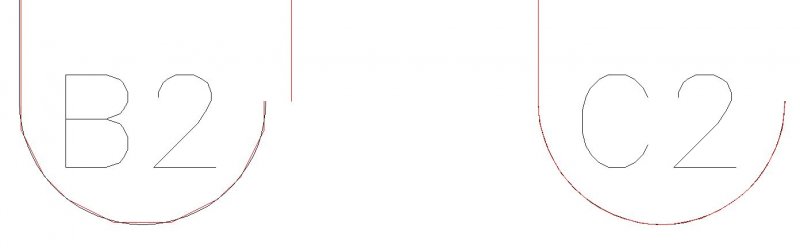

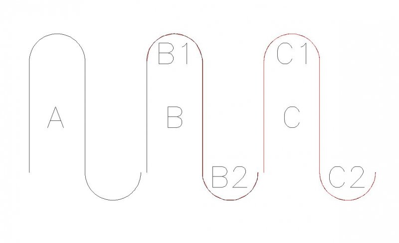

ReMark Posted October 31, 2013 Posted October 31, 2013 I think part of the problem is the resolution one specifies when using the MKSHAPE command. Look at the above image. Loop A is our polylined loop. Loop B is that same loop overlaid with its corresponding shape. I used the default resolution of 128. Loop C is the same polyline loop overlaid with its corresponding shape. However, in the case the resolution was set as 1024. Notice anything? Probably not. I'll fix that in a moment. Quote

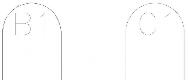

ReMark Posted October 31, 2013 Posted October 31, 2013 A closeup of the tops of loops B and C. Now do you notice anything? Quote
ReMark Posted October 31, 2013 Posted October 31, 2013 And here is a closeup of the bottom of loops B and C. Notice anything here? Quote
