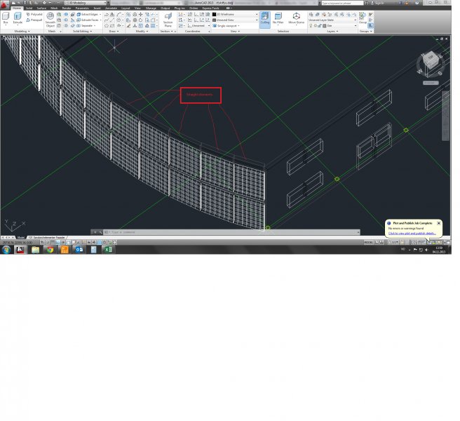

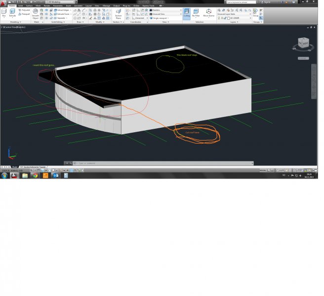

hvitost Posted November 4, 2013 Posted November 4, 2013 Hi! Benn looking around in here but i couldnt find anything that helped me, so; Im drawing a simple warehouse with a circular glas-facade, and i am using boxes for everything. Now, i want to cut the roof-boxes so that they fit with the circular wall... Ive tryed subtract, intersect, slice but nothing gets it right. Or i may be doing it wrong posting a screenshot for you to see. Thanks in advance! Quote
MSasu Posted November 4, 2013 Posted November 4, 2013 So you want to remove the canopy-like part? You may use SUBTRACT command for that, followed by a SOLIDEDIT with Separate option. Quote

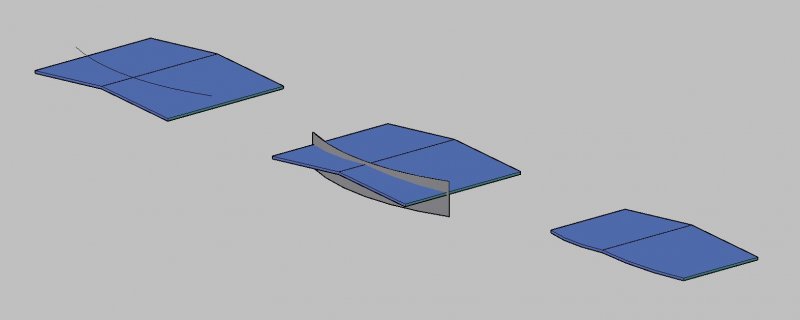

ReMark Posted November 4, 2013 Posted November 4, 2013 (edited) One option would be to slice the roof with a surface constructed from a curve that matches the interior face of your front wall. Sort of like this: I turned off the building layer so you could see the roof better. So we have the roof with an arc (left side). Roof with extruded arc (middle) which results in a surface. And we have the sliced roof (right side). Get the idea? Edited November 4, 2013 by ReMark Quote

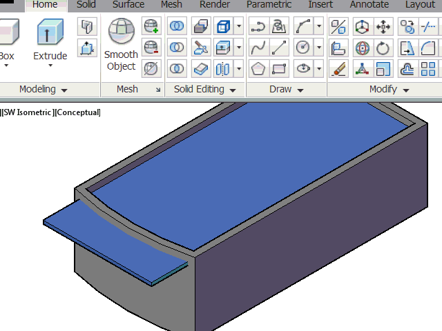

hvitost Posted November 4, 2013 Author Posted November 4, 2013 So you want to remove the canopy-like part? You may use SUBTRACT command for that, followed by a SOLIDEDIT with Separate option. I tried to do this but either the wall or the roof dissapeared. So i made a new box with a circular edge and extruded it instead. Its not a 100% fitted, but close enough for the purpose. Used your steps when making the new box, so thanks Quote

hvitost Posted November 4, 2013 Author Posted November 4, 2013 One option would be to slice the roof with a surface constructed from a curve that matches the interior face of your front wall. Sort of like this: [ATTACH]44980[/ATTACH] I turned off the building layer so you could see the roof better. So we have the roof with an arc (left side). Roof with extruded arc (middle) which results in a surface. And we have the sliced roof (right side). Get the idea? Yeah, think i get it. And it was almost like this ended up doing it. My circular wall isnt exactly circular, so i had to let the roof overlap the wall a bit. Ill be doing it your way from the beginning next time Quote

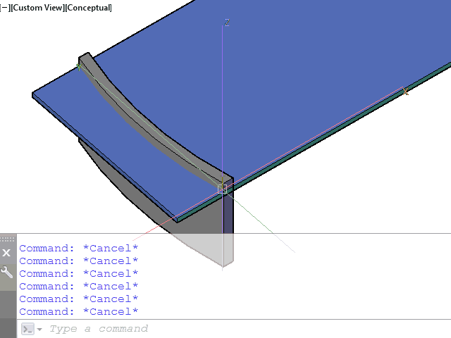

nestly Posted November 4, 2013 Posted November 4, 2013 I always prefer to use the INTERFERE command because there is no need to create or copy any objects to complete the operation. Procedure: INTERFERE command Keep "interference" object(s) Subtract "interference" objects(s) Separate the solid into individual pieces Delete unneeded parts Quote
hvitost Posted November 4, 2013 Author Posted November 4, 2013 Ive been trying to do this now nestly, but when im going to separate it says : The selected solid does not have multiple lumps. ?? Quote
nestly Posted November 4, 2013 Posted November 4, 2013 That message probably means you did not successfully subtract the "interference" object, or the "interference" did not extend all the way to the edges of the "roof" Quote
hvitost Posted November 4, 2013 Author Posted November 4, 2013 That message probably means you did not successfully subtract the "interference" object, or the "interference" did not extend all the way to the edges of the "roof" [ATTACH=CONFIG]44985[/ATTACH] Alright, that might be one of the problems. Ill check it out first thing tomorrow morning Quote
hvitost Posted November 4, 2013 Author Posted November 4, 2013 yup, about 2-3 degrees or so. Is that a problem? Quote
ReMark Posted November 4, 2013 Posted November 4, 2013 yup, about 2-3 degrees or so. Is that a problem? It could be depending on how you went about creating the roof in the first place. We don't have access to the drawing so it's anybody's guess. Sometimes the devil (a problem that occurs) is in the details. Quote

hvitost Posted November 13, 2013 Author Posted November 13, 2013 Alright, that might be one of the problems. Ill check it out first thing tomorrow morning Hey guys. Long time, no update... I did check this out and could not find the reason why this did not work. I made sure the "interference" did extend all the way to the edge of the roof, but i still couldtn do it. Maybe youre right about the pitching ReMark, i dont know. So, i got frustrated, accepted the almost-there-solution, and took a break from this. Will not be trying any further either, untill a similar project comes along. Ill try to do it correctly from the start next time.. And, yes JD Mather, it does feel like that. What i do in 2 hours in Revit, i nedd 2 days to do it in autocad. Guess ill have to try convincing my new employer to belive that, and get a licence for Revit as well Quote
