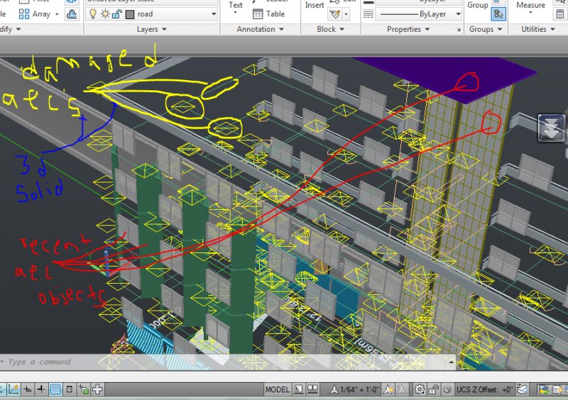

Hi, please help me with this.. I've been working on this project for so long and today when i saved the 3d model, created with autocad architecture 2014,and reopened it, the walls , slabs, doors all changed into lines, but the 3d solids remained the same....i 've attached a photo what happened to my model. Please help!!!Capture.jpg
The original drawing was created with AutoCAD Architecture 2014 but you are editing it using plain AutoCAD 2012? Did you explode these objects at some point? Could it be that you need to install an object enabler?
I don't know about what object enabler does but i'm downloading it now... All that happened was 3 hrs ago i saved my drawing and thought to recheck once and after opening suddenly i found the aec objects are converted into disgusting lines, but a thing to notice,, not all aec objects converted,, the recently created aec objects before saving are fine displayed,, objects created before i started to edit the drawing,eg other walls, slabs, doors are gone..!!!! And also the autocad 3d solids are too fine.Capture2.jpgCapture2.jpg
Hey, i found the solution friends,, if you are having similiar trouble, enter command RECOVERALL and it asks location of the dwg file, once you specify it, the drawing gets recovered. Feeling so recovered myself. Thanks ReMark for your support. :D
