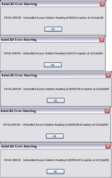

skipsophrenic Posted November 26, 2008 Posted November 26, 2008 for the past two weeks sometimes if i try to save AutoCAD shuts down without warning and I lose at least half an hours work. (I run do a q save every 10 mins) and then i come up with one of the following error messages. To say this is annoying would be like saying the sun's a little hot. Does anybody have any ideas. - p.s. there are at least 7 nested xrefs!!!! Quote

skipsophrenic Posted November 26, 2008 Author Posted November 26, 2008 2GB RAM XP Pro, on board graphics (Works comp) all sp's uploaded, trouble shooted unload an reload the main xref\unloaded the not needed xrefs, purge\audit and drank WAY too much coffee for time of night (17:25 GMT) Oh an drawing was started in microstation and converted, i received it already nested - personally i HAT nested xref's. Quote

ReMark Posted November 26, 2008 Posted November 26, 2008 "...drawing was started in microstation and converted..." Maybe it's a bad Regapp. Try the purge command but this time do it from the command line an add a dash in front of it like this: -purge Regapps is one of the options in the list for purging unused objects. Purge them and see what happens. Quote
skipsophrenic Posted November 27, 2008 Author Posted November 27, 2008 well after a bit more investigating, not sure which buried xref it is (yet) but turns out one of them's corrupted. (I HATE NESTED XREFS!) So i've gone into the drawing I need the info off and done a staightforward copy with base point, looks like it's done the trick. Quote
