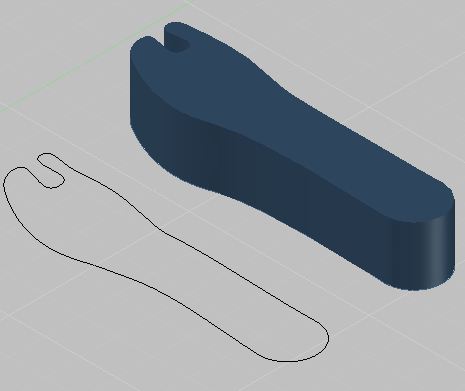

cannot extrude into solid but gives me surface extrude
im drawing by using spline and cannot extrude into solid after I change the height along z axis..how can i make it into solid? here my drawing.. i try using loft but also give surface loft
Drawing4.dwg
You will need a closed contour in order to get a solid. Please check SPLINEDIT command.
You can use the PRESSPULL command to give your profile a height. Works on lines, arcs, polylines and splines.
