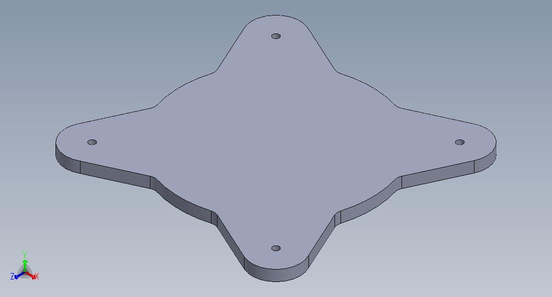

Hi, thanks for the reply.
Here is 1 of the 2 files I need in 2D DXF format, it's the SLDPRT file. I suspect you're right that the IGS file was created from another format.
Here is the part

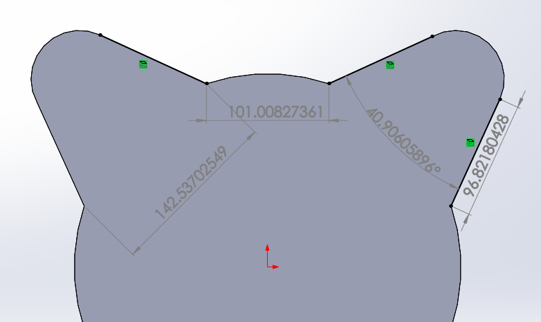

The part is not fully defined and the dimensions don't make logical sense to me?
What is the angle supposed to be?
The 40.9 angle? It's irrelevant and shouldn't be there. It's only the outer shape that's important along with the location of the 4 holes (not shown in the above).
There are fillets missing on your drawing, either end of the 101 dimension.
Edited by LordOxygen
Those dimensions are not what was entered into the CAD program. They were round numbers, clearly something has gone wrong with my file and is causing problems.
None of these numbers were entered in creating the part in SolidWorks.
These were my dimensions in attempting to understand the geometry.
The feature tree was rolled up above the fillets and holes to analyze one feature at a time.
It appears to me that the SolidWorks user needs basic training in defining part feature dimensions.
The manufacturer will have the same questions as these dimensions are not measurable and therefore cannot be sure of meeting specifications.
Ah, ok they're your numbers.
That may be the case, he's a friend just trying to help. He did do a very good job with some other parts I need (this is for a precision DIY project).
Do you have a dimensioned drawing or hand sketch?
The correct angle dimension should end all doubt.
Makes sense why they're having problems now you've explained, so thank you! Yes I do have a 1:1 hand drawn sketch, with enough dimensions to draw the shape. I'll have another chat with my friend, I'm sure we (he) can work this out.
