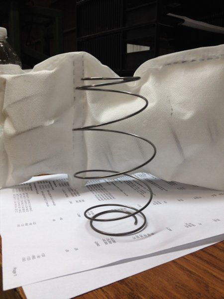

Cadbee26 Posted November 13, 2013 Posted November 13, 2013 Hi I am trying to draw an elliptical coil spring with top and bottom radius of 2 in and center radius of 3 in with 5 turns and spring ht of 5 in. the wire guage is 0.1in. I could draw a cylindrical spring with helix and sweep command but dont know how to draw an elliptical coil spring. please let me know the commands or steps to get it. Also, I have problems in getting dimensions of radius and height for the coil spring. I use autocad 2014. Thanks Quote
Cadbee26 Posted November 13, 2013 Author Posted November 13, 2013 (edited) Hi Thanks for replying. The image looks more like a cylindrical coil. is the top and bottom radius smaller than the center coil radius. I am trying to draw the one on the pic. I want to know how it can be done in AutoCAD 2014 Edited November 25, 2013 by Cadbee26 Quote
JD Mather Posted November 14, 2013 Posted November 14, 2013 I have no idea how to do that in AutoCAD, but it would be fairly easy in Autodesk Inventor. (if you had posted that picture in original thread - that is what I would have modeled) Quote
nestly Posted November 14, 2013 Posted November 14, 2013 HELIX with a bottom radius=2, top radius=3, turns=2.5, tWist=CCW, height=2.5. That should take care of the "bottom" half, then flip it over for the top half. Sweep the top and bottom half separately then UNION them, or Explode both helix into Splines and join them. (Disclaimer... AutoCAD Helix are not particularly accurate) Quote

JD Mather Posted November 14, 2013 Posted November 14, 2013 From the image it also looks like the "helix" is variable pitch with a transition to flat at the ends. Quote
