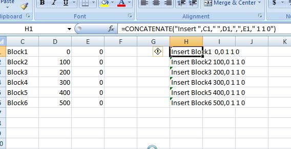

insert multiples blocks side by side
How to use the insert command to insert blocks from Zero,
and the next be inserted side by side:
ex
block a
block b
block c
Block a = Position 0 (OK!)
Block b = block a + 1cm (position to the right)
Block c = block b + 1cm (position to the right)
The result is this
[bLOCK A] [bLOCK B] [bLOCK C]
the code
(command "insert" (strcat "*BLOCKA") "0" "1" "0" "1")
;;; how to calculate next point , + 1cm (position to the right)
(command "insert" (strcat "*BLOCKB") "0" "1" "0" "1")
(command "insert" (strcat "*BLOCKC") "0" "1" "0" "1")

Another way is to use excel to create a script for you, you have a column of block names a starting X & Y then just make a new column that combines them just paste the column to the command line.
