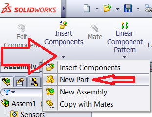

I think you're looking for 'create component' - not 'insert component'. It may be hidden in a drop down under the insert command...
To have an assembly of parts, you must, of course, have parts.
To create New Parts at the assembly level - click the New Part icon.
